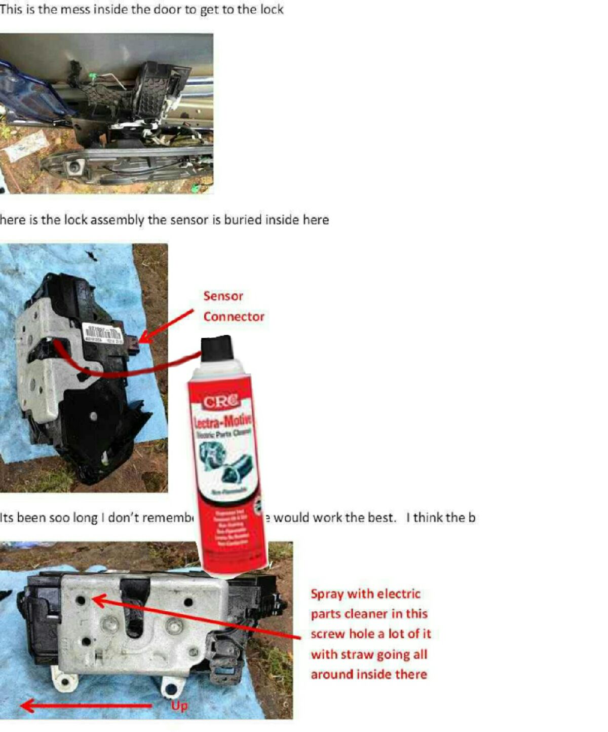

hunter14 Posted April 29, 2015 Report Share Posted April 29, 2015 Red, my alarm started going off in the middle of the night too. The car alarm thinks the door opens. I couldn't stand it and didn't have a warranty to take to the dealer so I took the door apart to find out what was happening and fixed it. It been 2 years and I haven't had a problem since. Ā I made the original post to use the electric cleaner in May 2013. I wouldn't bother spraying the key hole, its hardly connected by sensor. Its a mess to take the mechanism apart to spray the sensor, but like I said, I haven't had a problem again in 2 years. I quick alternative is to spray through a particular screw hole noted in my earlier post, but I don't know for sure if that works, it seemed like it would if you got a straw to go deep into the mechanism, using electric spray cleaner not a greasy lubricant. Quote Link to comment Share on other sites More sharing options...

hunter14 Posted April 29, 2015 Report Share Posted April 29, 2015 I'm trying to get pictures upload, they should be attached to this. 1 Quote Link to comment Share on other sites More sharing options...
2011edgese Posted April 29, 2015 Report Share Posted April 29, 2015 I'm trying to get pictures upload, they should be attached to this. awesome! Quote Link to comment Share on other sites More sharing options...
2011edgese Posted April 29, 2015 Report Share Posted April 29, 2015 (edited) Makes sense why my angle of sprayl works! I'll post a diagram . .. hand drawn. Edited April 29, 2015 by 2011edgese Quote Link to comment Share on other sites More sharing options...
Red2149 Posted April 29, 2015 Report Share Posted April 29, 2015 Thank you! At least I know I'm not going crazy and my car is about to fall apart. I called Ford Customer Service yesterday and let them know how ridiculous this is getting. I work in an urban area in an emergency room and on an ambulance....when I work second shift and get out in the dark of night, the first thing I used to do is lock my car door. Well, since this has started happening, I can't lock it with the sensor still going off...it pops up all my locks, which makes it easy for anyone to slide in any door if they wanted...so I used that as a real pushing point with Ford, didn't seem to matter though. Ā I'll try spraying the entire rest of the can in there today, and maybe one of my mechanic friends can figure out what to do. My extended warranty is expired, but I do have another one with Zurich...however they are saying this isn't covered, and taking the door apart at Ford will cost me an arm and a leg. Ugh. I'll take a look at those pics. So glad to have this forum otherwise I'd be spending money left and right. This has been my only Ford problem ever...hoping it's my last problem because I really do love this car. Quote Link to comment Share on other sites More sharing options...
2011edgese Posted April 29, 2015 Report Share Posted April 29, 2015 Thank you! At least I know I'm not going crazy and my car is about to fall apart. I called Ford Customer Service yesterday and let them know how ridiculous this is getting. I work in an urban area in an emergency room and on an ambulance....when I work second shift and get out in the dark of night, the first thing I used to do is lock my car door. Well, since this has started happening, I can't lock it with the sensor still going off...it pops up all my locks, which makes it easy for anyone to slide in any door if they wanted...so I used that as a real pushing point with Ford, didn't seem to matter though. Ā I'll try spraying the entire rest of the can in there today, and maybe one of my mechanic friends can figure out what to do. My extended warranty is expired, but I do have another one with Zurich...however they are saying this isn't covered, and taking the door apart at Ford will cost me an arm and a leg. Ugh. I'll take a look at those pics. So glad to have this forum otherwise I'd be spending money left and right. This has been my only Ford problem ever...hoping it's my last problem because I really do love this car. yup... you have the worst of everyone i come across worth this issue. Alarm going off and doors unlocking. Im sure you are also experiencing the dome light turning on and off randomly during thenight as well. Thats what mines does. All through the night it cones on and off. Draining the battery. Luckily it had never drained it ccompletely. Looks like you are being forced to fix it asap. And yes, you have to spray the whole can. Don't go cheap with it, just spray the death out of it. Quote Link to comment Share on other sites More sharing options...
2011edgese Posted April 29, 2015 Report Share Posted April 29, 2015 (edited) Ok... this is how i exactly spray the latch. Get the straw to bend upwards so the can is somewhat straight so it pushes the liquid and not air. This has worked great for me. But now that i know the bolt trick, ill attempt it next time the sensor sticks again. and get the tip all the way inside. Wiggle it so it sprays everywhere . Edited April 29, 2015 by 2011edgese Quote Link to comment Share on other sites More sharing options...
