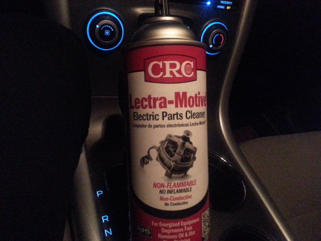

2011edgese Posted November 26, 2014 Report Share Posted November 26, 2014 okay I have an update. So after almost a full year of the electronic spray actually working for me a hundred percent, 2 days ago the light came back and now it's fully lit and no matter how many times I open and close the door the light is on. So about 30 minutes ago I ended up going to the auto store and bought a whole can of electrical cleaner from the C and R. And this time I did a new test, since another member said that if you put in the key on the key lock and open close open close the key lock that somehow fixes the problem, I just decided to put the little red straw inside the keyhole and give it a one second burst. And guess what? The light is gone. So it looks like you don't have to spray the latch like I did initially a year ago, but spray inside the locking mechanism in the keyhole. So anyone with the same problem give that a shot, the light is completely gone and its been over an hour now. Quote Link to comment Share on other sites More sharing options...
2011edgese Posted November 26, 2014 Report Share Posted November 26, 2014 (edited) Here's the product that works. and let me correct myself, I don't think it was one second, it was more like half a second that I gave it. so I highly suggest everyone to buy this product, its was only $8.50. It's worth the try since dealers are charging up about 300 to 500 dollars to have this replaced. You can't beat A simple $9 fix.for those who have not read the whole thread, here's a brief on my experience. I sprayed the door latch inside the door on the side and sprayed inside the keyhole. I sprayed the whole can last time and top it off with a little spray of wd-40 just to add lubrication. And that gave me a whole year of no problem. And beware, if you spray only wd40 or any type of lubrication on the latch or the keyhole that's a large amount, it's guaranteed to keep the light on. For some reason wd40 on the circuit makes it fail, it's block the connection that makes it ground itself off. Trust me I spray the whole can of wd-40 on it to see if that would fix my issue and its only made it worse. Good luck everyone, I still love this car tremendously. And I do get compliments on how nice the car look. Edited November 26, 2014 by 2011edgese 1 Quote Link to comment Share on other sites More sharing options...
