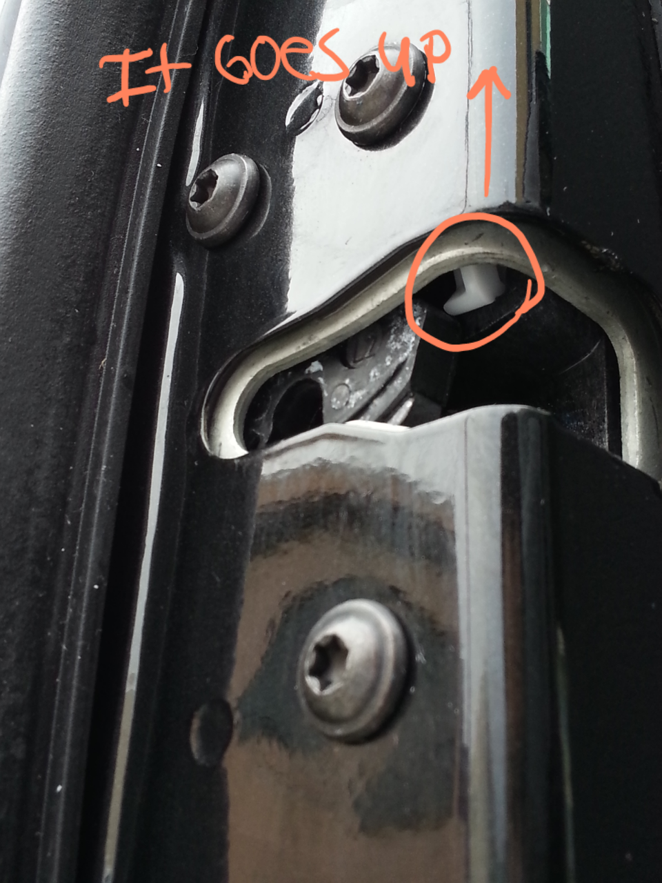

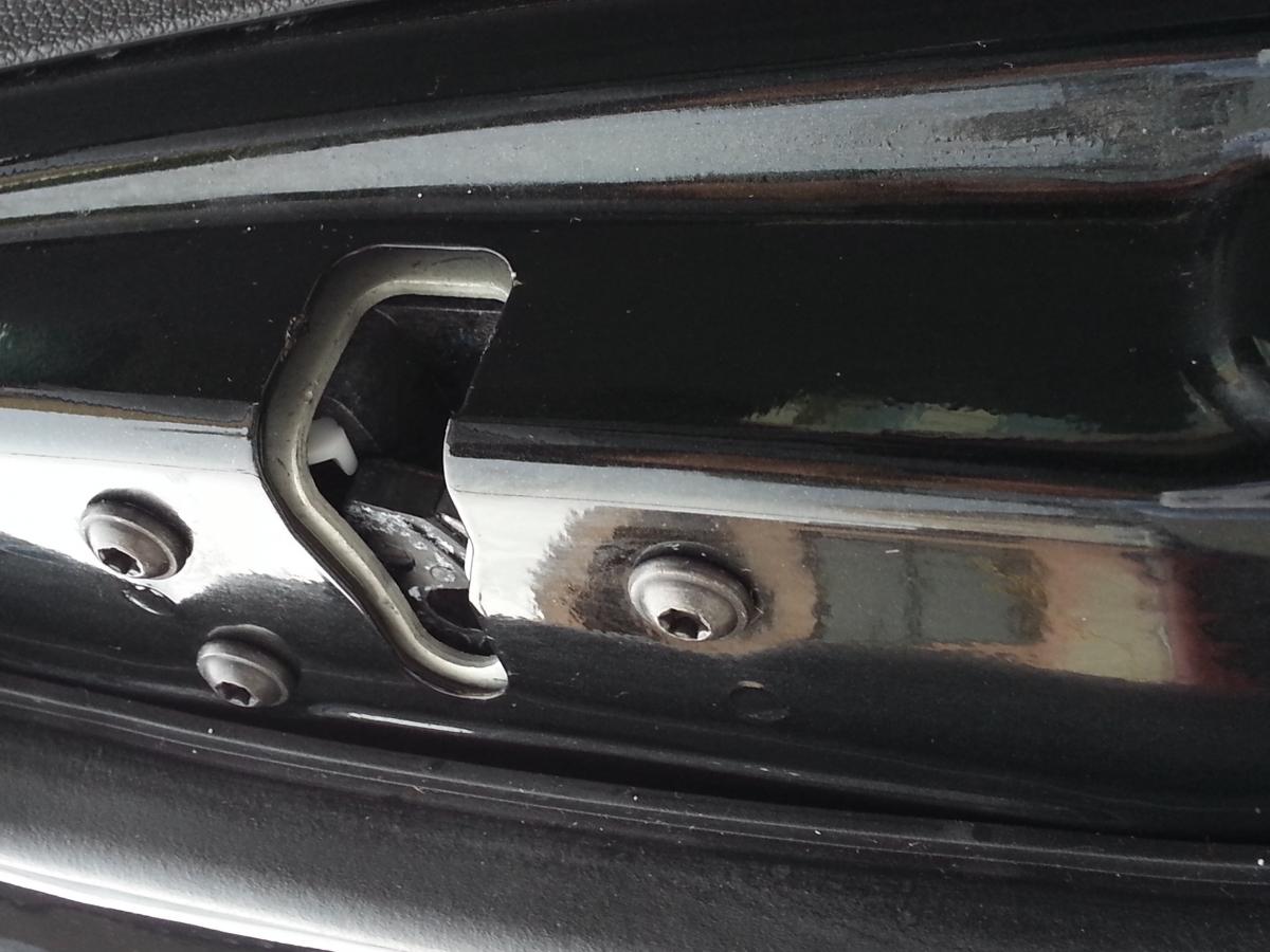

Here is a update. Been 7 days since I sprayed electric cleaner. On the 4th day, I opened the door to spill extra coffee on the road when I was on a red light. The ajar stay on. I reopened it and closed it normally, ajar went off. It did it again on the 5th day and just reopened and closed it normally and it always goes away. So. .. This morning I decided to spray wd40 inside the latch without removing the door panel in which I have never done. I sprayed it good so it reaches everything. Guess what? The ajar light came one when I closed the door and refuse to go away no matter how many times I closed the door or even when i closed it rather hard. It stay on for a good 3 minutes until I decided to spray electric cleaner again. I soaked it really good and guess what? Ajar light is gone and hasn't come in the whole day again. So stay away from wd40 on this issue! Use electric cleaner!
That's explains why when I read some people hosing down the latch worth only wd40 said that it stays on no matter how much you spray. Lol. Wd40 DOES NOT work! Use brake cleaner like a previous poster said or electrical cleaner. Some say brake cleaner eats plastic and destroys the housing. But I never seem that happen unless you leave a item dipped in our over night. But I stayed on the safe side amnd used electrical cleaner. But any how, this is the sweet spot. Put the straw right where I have it and spray. You can adjust the straw to hit the whole area squared in orange.
Edited by 2011edgese
  • Like 4
See this white arm? That's the mechanism that gets pushed up when you close the door. That works fine going up ams down but the actual circuit seems to be the culprit. I can push it up and down with a pen and it glides smoothly. When you pushed it all the way up, you hear a click in the center console. Meaning it is sending the signal that the door is closed. When it gives the ajar warning, you can push the arm up and you wrong hear click in the center console. Once I spray it with the cleaner, then I get the click. I manually pushed the latch with my finger to simulate the door locked, that's why you see the white arm. If you try this, remember to pull the door handle to unlock the mechanism when you shut the door. . Otherwise when you close the door, it will bang hard. Also. . This leads me to believe it's not a mechanical issue.
