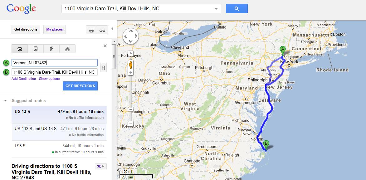

wlepse Posted June 14, 2012 Report Share Posted June 14, 2012 (edited) You do have the ability to download directions to your vehicle from both Google and Mapquest using Sync Services. Your dealer should be offering free classes to there customers on this. I have been teaching classes to customers at a local Ford Dealer For 14 months.Attached is an instruction book on using Sync Services which is free for 3 years to the first owner of most new vehicles. It also allowes you to download turn by turn directions. Unless they have changed things this isn't quite true. You can go to google or mapquest and send a destination address to sync services and in turn to the vehicle but you can't send the routing from either website to you vehicle. So while sync services may provide a different routing than the nav unit it still isn't a customized route that you can make easily on google. I really wish Ford would add this functionality because the nav routing is often painful and I simply don't trust it. Perfect example was a few weekends back I took the family out and the routing took us the long way, but on the way back it took the expected route. I have it set to default to quickest way and no longer have traffic so this is definitely a quirk in the software. Saw the same thing on a much longer trip last year and I am worried about this summers road trip to the Outer Banks. I simply don't trust this nav unit. My TomTom I got on clearance at Target for 30 bucks blows it away in accuracy, functionality and user friendliness. Just did a quick double check...unless neither site has updated its walk through to send to sync they clearly say destination only. Edited June 14, 2012 by wlepse Quote Link to comment Share on other sites More sharing options...

ladybird4 Posted June 15, 2012 Report Share Posted June 15, 2012 Sync Services does not determan the route directions whan using google or mapquest. What ever directions these 2 sights determan is what will be downloaded to your car. The only thing that Sync Services is doing is providing a place to send the imformation so it can be sent to your car. Also as you requested attached is a list of voice commands. It's 37 pages long and contains everything you should be able to say. More than my pea brain can remember. If anyone needs more help you can send me a message I am not an expert and do not have all the answers but do teach this to customers every week. File was in word format and i had to save it and send it as a Pdf file. If you dont get it pm me with your e-mail address. SYNC GEN 2 Voice Commands 2.pdf Quote Link to comment Share on other sites More sharing options...
wlepse Posted June 15, 2012 Report Share Posted June 15, 2012 Thanks...I am going to review that pdf and see if I am doing something wrong. But something else popped in my head last night. We do get a lot of noise when using the phone which has been attributed to mic noise. Does anyone know if this is an issue with the way it works over BT or if anything using the mic would have this noise? Just wondering if part of my voice recognition issues are because of the whooshing sound in the background. Didn't know that about the google and mapquest. Will have to pick a couple of wacky routes and send those over to try. Quote Link to comment Share on other sites More sharing options...
akirby Posted June 15, 2012 Report Share Posted June 15, 2012 Thanks...I am going to review that pdf and see if I am doing something wrong. If you have Nav it only sends the destination then your Nav determines the route. If you don't have Nav it sends turn by turn directions through Sync Services. Quote Link to comment Share on other sites More sharing options...
wlepse Posted June 15, 2012 Report Share Posted June 15, 2012 If you have Nav it only sends the destination then your Nav determines the route. If you don't have Nav it sends turn by turn directions through Sync Services. Crap...that is what I thought but it seemed ladybird4 was indicating otherwise. Sucks because like I mentioned above I find it much more intuitive and user friendly to manipulate a route on google than the MFT. Akirby...any input on the mic question? Quote Link to comment Share on other sites More sharing options...
