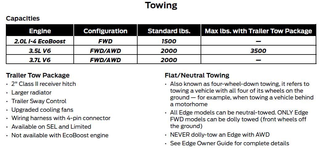

Haz Posted March 3, 2013 Report Share Posted March 3, 2013 (edited) Cajun: Attached image shows 2012 Ford Edge trailer towing capacities with & without factory-installed Class II Trailer Tow Package... Good luck! Edited March 3, 2013 by Haz Quote Link to comment Share on other sites More sharing options...
Will S. Posted March 25, 2013 Report Share Posted March 25, 2013 So factory-installed towing package nearly doubles the towing capacity, as it includes more than the hitch receiver and wiring. Definitely worth the modest cost of that option, when buying new. Quote Link to comment Share on other sites More sharing options...
