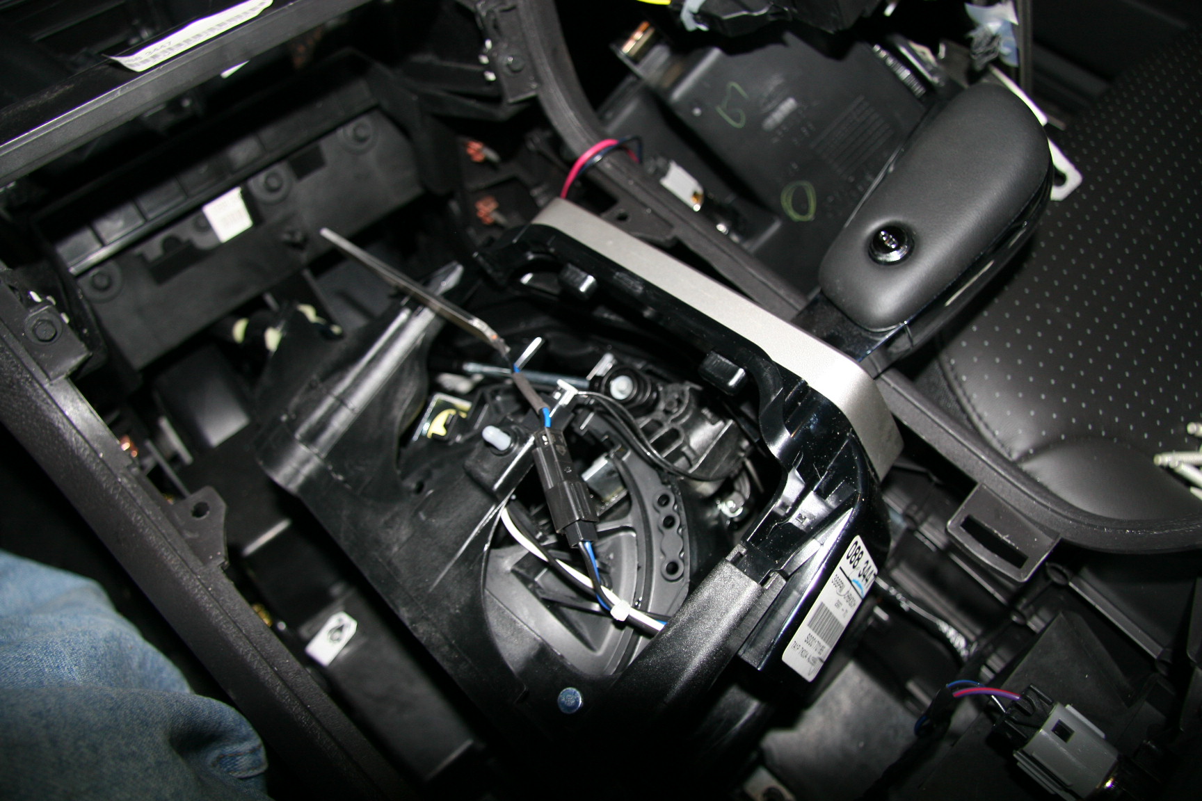

07 MKX Posted September 1, 2007 Report Share Posted September 1, 2007 All fixed. The Service Manager did the fix. It just took a few minutes. OK, I admit I was skeptical of this, So tonight I broke my console apart. It's easy to pry the plastic pieces up and away from the console. You will need a 5/16" socket and at least a 6 in. extension. When I got the light strip away from the PRNDL indicator, I looked it over. The photo on the right is looking at the light strip from the bottom. Other than that, it's just a strip of glass. I tried everything I could to see if all connections were correct. I've notified my dealer about him getting me a new one. Thanks for the heads up on this. All this time I figured it was a cost savings move on Ford's part. Guess it actually was, hope they got these defective light strips at 1/2 off. 1 Quote Link to comment Share on other sites More sharing options...
Edgepa Posted September 1, 2007 Author Report Share Posted September 1, 2007 Glad to be of help 07 MKX. Nice photographs of the gear selector module and the light panel. The service manager said all he had to do was plug the panel in. There was no defect, just overlooked during assembly or not properly plugged in...was his guess. With that panel lit it makes it a lot easier to maneuver the vehicle when parking at night! Please update when the cause of your outage is determined by the service technician. Hope you get light soon! Quote Link to comment Share on other sites More sharing options...
