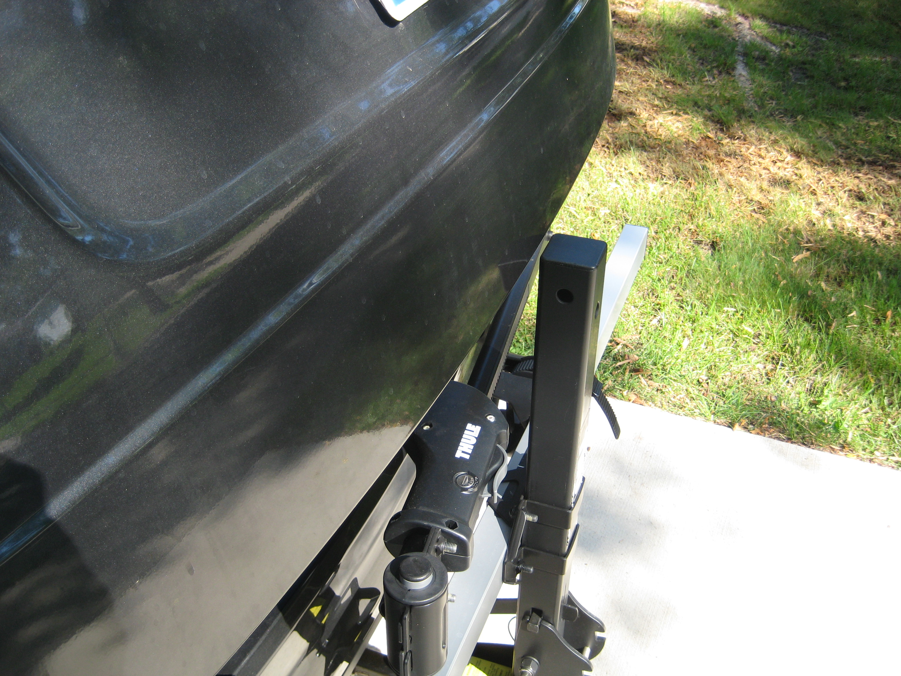

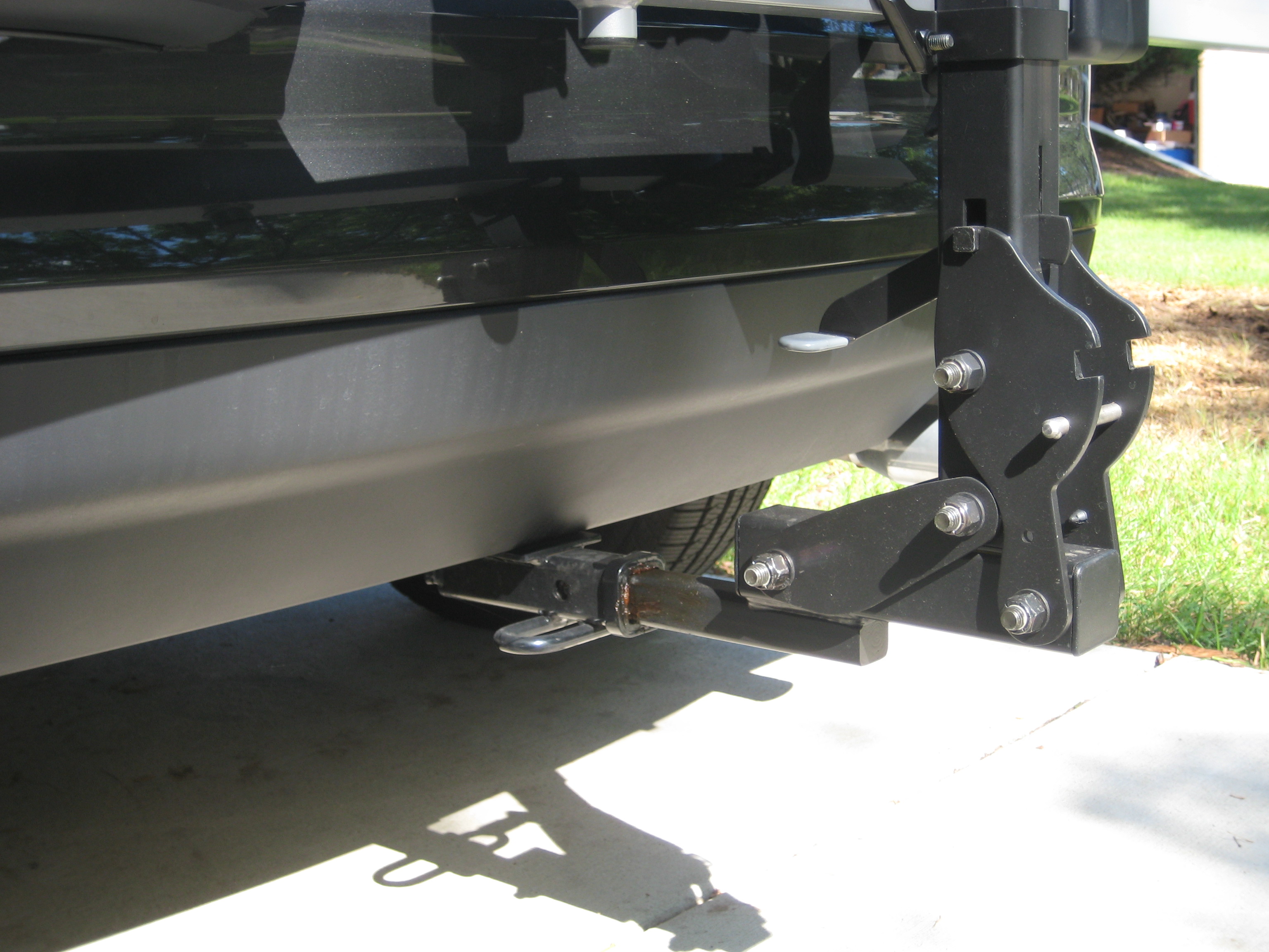

lml427 Posted August 30, 2007 Report Share Posted August 30, 2007 (edited) After some research into after market hitches I have found out that DrawTite, Reese and Hidden Hitch are now all the same company and that there hitchs for the Edge are identical except the name. I purchased a Hidden Hitch from E-trailer.com and installed it myself in my driveway. The directions are simple and precise. You will need to trim the heat shield to allow room for the new mounting bolts. Here are some pictures with a Thule T2 bicycle rack mounted. The rack has been milled 1/2" so the rear hatch can open, the plastic wheel hoop was trimmed and I have only one of the bike trays on. Edited August 30, 2007 by lml427 Quote Link to comment Share on other sites More sharing options...
