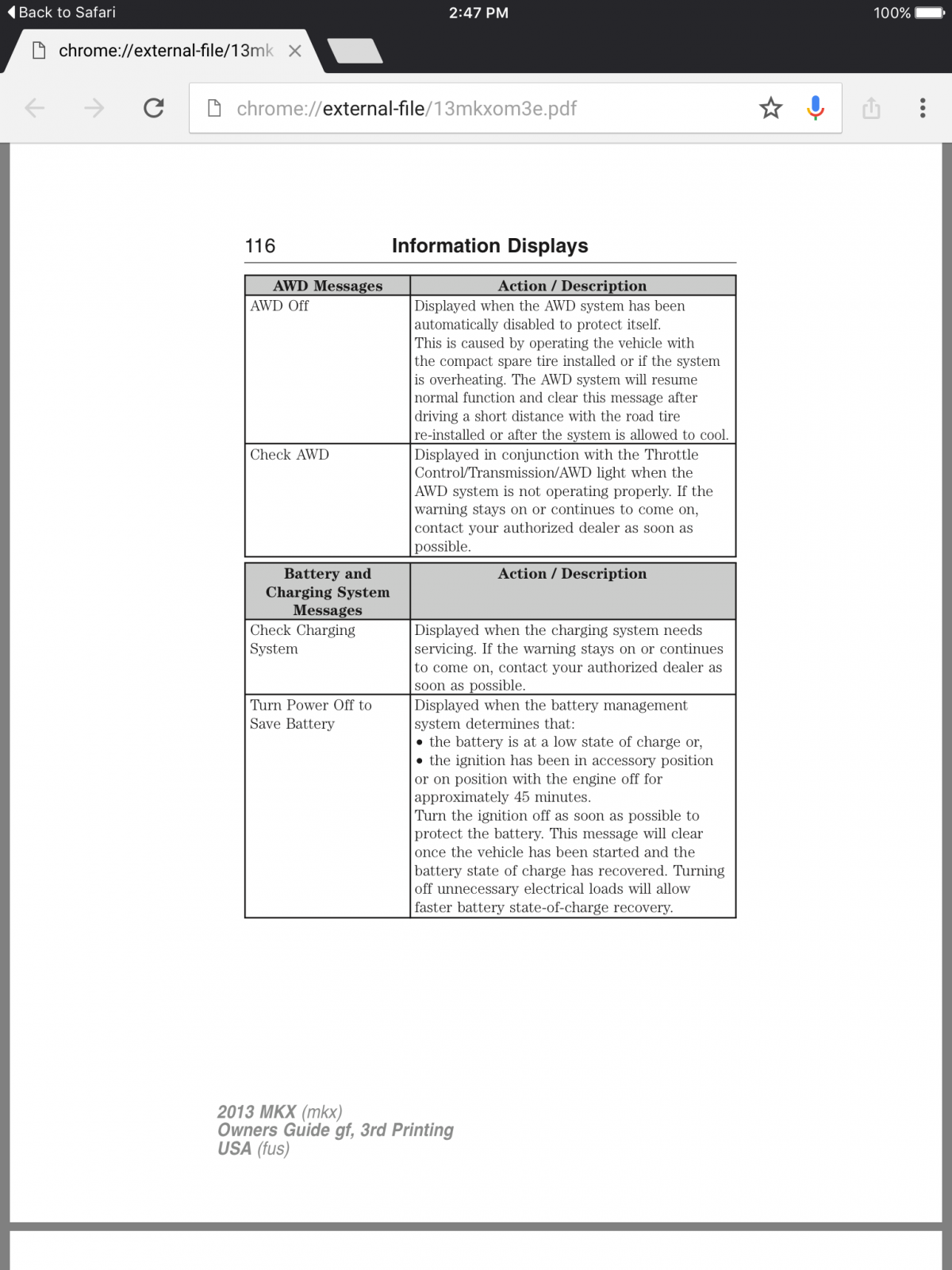

Cottonpickerboi Posted August 28, 2016 Report Share Posted August 28, 2016 The message references Battery Power is low, in my case I kept leaving 4 Port Aux-Power Adaptor, connected (Laptop, iPad etc...) overnight. Now in the habit of pulling the PLUG before exiting my Car @end of day. Page 116, Lincoln Owners Manual Third (3) Printing "No Action required by Driver" Quote Link to comment Share on other sites More sharing options...
