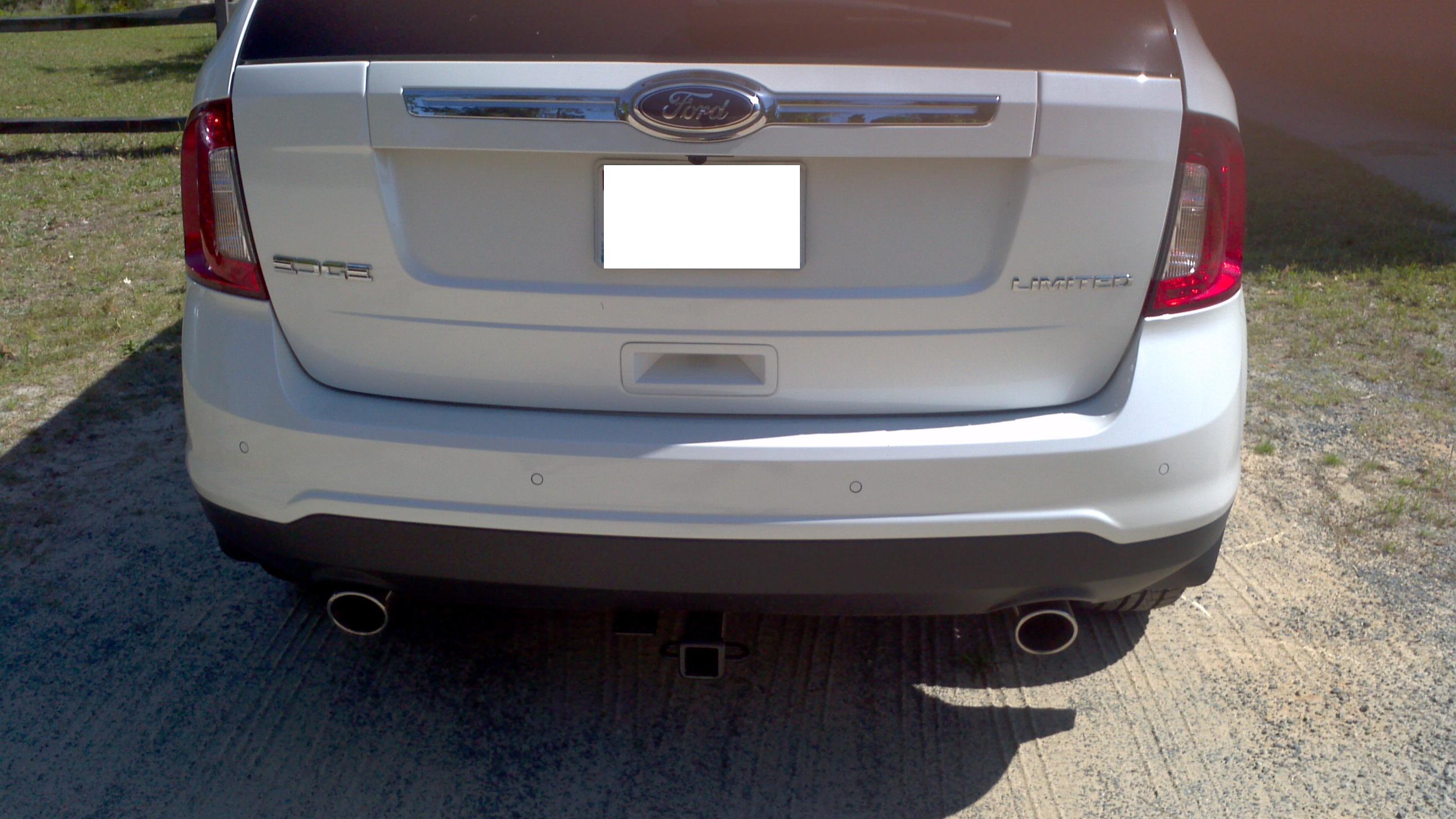

NCHeel Posted April 12, 2012 Report Share Posted April 12, 2012 Sorry if the lighting is not so great. I got the Draw Tite 75709 for my 2012 Limited from etrailer. You only see the receiver and the little plate where you can attach a wiring harness/box. There is no need to cut out the trim. The very middle gets pushed up maybe an inch and there is no way you would notice this unless you were looking for it AND were looking at it from ground level. Installation was not anything technically difficult and it took less than an hour. The hardest parts were getting the rubber muffler hangers loose and fishing the wires through the bolt holes and that was only so because of the somewhat awkward position laying under the car on a creeper. I only got this to use a hitch mounted bike rack, so I did not get a wiring harness. 1 Quote Link to comment Share on other sites More sharing options...
fishx65 Posted April 12, 2012 Report Share Posted April 12, 2012 Thanks for taking the time to post the pics NC!! Looks like a nice clean install. If I remember correctly, Hidden and Drawtite are pretty much the same hitch for the 2010 so I would guess that the two are the same for the 2011+. Gotta get going on mine soon! Quote Link to comment Share on other sites More sharing options...
Gator Posted April 13, 2012 Author Report Share Posted April 13, 2012 Thanks to RCHeel and rpeary for posting pics. There are so many posts talking about one hitch or another, but it is nice to be able to compare the looks of the different brands on one page. The DrawTite seems to be more low profile, but the Curt hitch looks nice also. Decisions, decisions... I'm also concerned about putting a hitch on and it hitting the curb whenever I back into a parking spot. The Edge is still somewhat new for me, and the ground clearance is much lower than what I use to have. Thanks again. Quote Link to comment Share on other sites More sharing options...

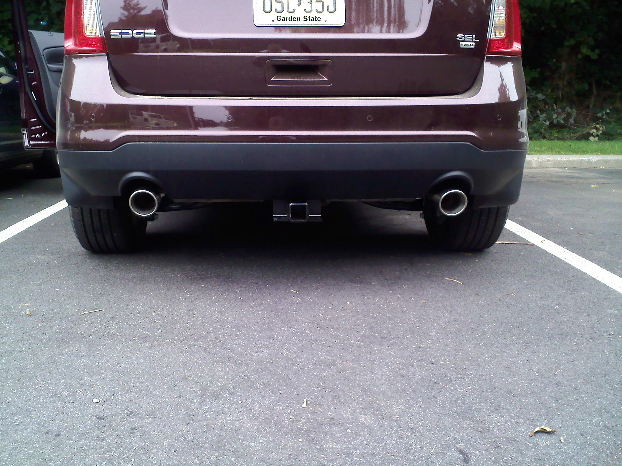

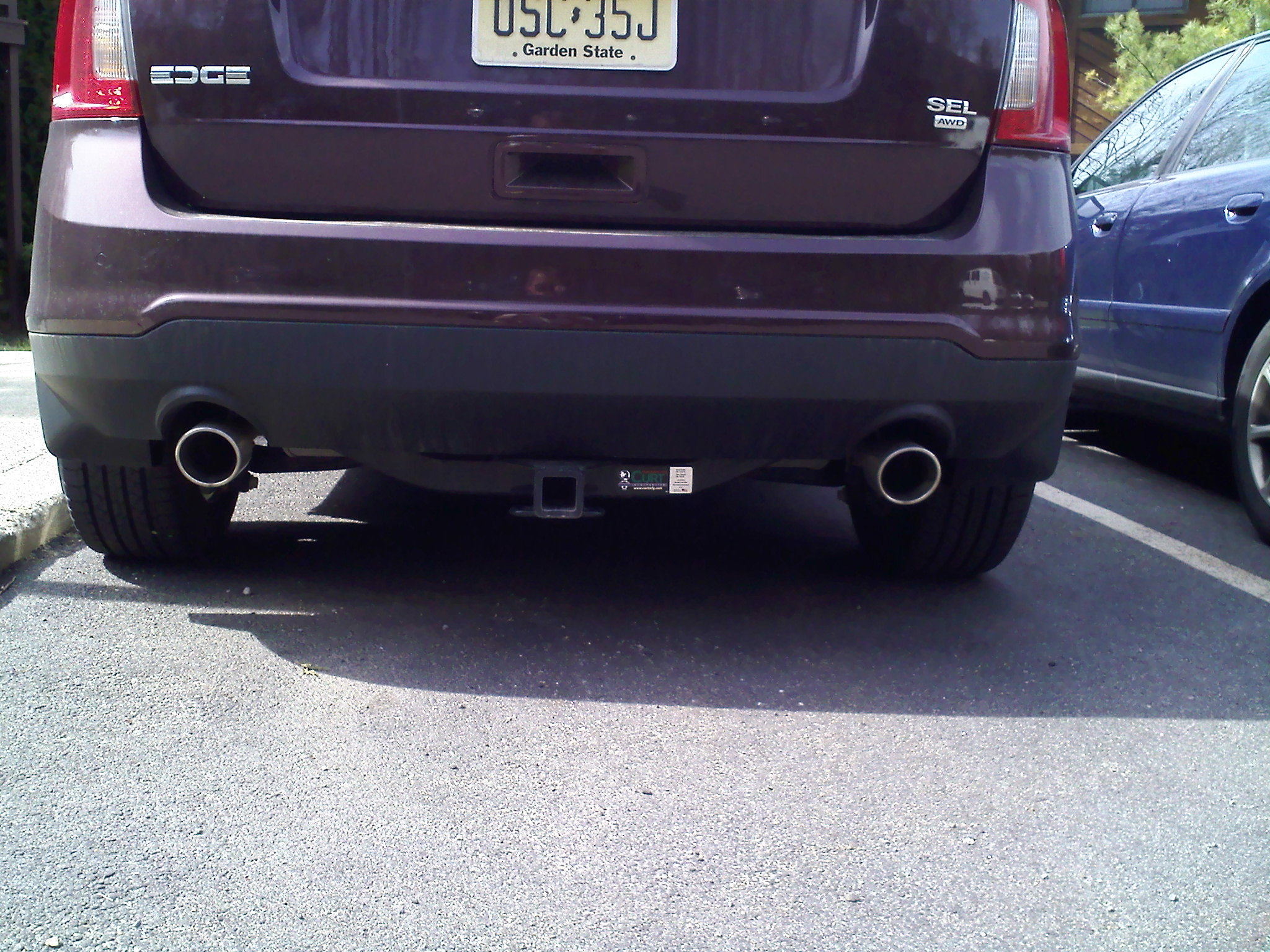

wlepse Posted April 14, 2012 Report Share Posted April 14, 2012 Originally I purchased a Valley 82162 hitch because the plan was to follow another thread here and modify the reciever so that nothing was seen. The directions for the Valley hitch do say to drill but you don't have to...just follow the instructions from one of the other manufacturers and you are fine. The hitch was well made, clean welds good paint quality and fit to chassis was spot on. No need to cut the bumper and the only part you see is the actual reciever. It also stuck out less than the new one we have. The reason I have a new one is while this bolts up perfectly there is a slight interference with the newer exhaust set up on the Edge. Below are the pics. 1 Quote Link to comment Share on other sites More sharing options...
wlepse Posted April 14, 2012 Report Share Posted April 14, 2012 So after having the Valley installed for a few weeks we decided we couldn't live with the occasional clanking so we went out and bought a Curt 13067 since it was the only one at the time I could confirm with the manufacturer would fit. I would have rather gotten the Hidden or Draw Tite since the cross bar is behind the bumper but the manufacturers weren't aware of the exhaust change (at the time). So we ended up with the Curt. Initial impressions was not great. While it looked like it was packed well the flanges were bent a little and I had to man up and bend it back. Other than that the paint appears to be slightly better than the Valley but it could just be a glass vs flat issue. I don't care for the big bar being so visible but it works and is quiet so that is fine. It also sticks out a bit further than the Valley did. I find the reciever to be a little loose but I made my own anti-wiggle pins to take care of it. Hope the pics and info help some in their search. Quote Link to comment Share on other sites More sharing options...
carbonedge+ Posted April 15, 2012 Report Share Posted April 15, 2012 So after having the Valley installed for a few weeks we decided we couldn't live with the occasional clanking so we went out and bought a Curt 13067 since it was the only one at the time I could confirm with the manufacturer would fit. I would have rather gotten the Hidden or Draw Tite since the cross bar is behind the bumper but the manufacturers weren't aware of the exhaust change (at the time). So we ended up with the Curt. Initial impressions was not great. While it looked like it was packed well the flanges were bent a little and I had to man up and bend it back. Other than that the paint appears to be slightly better than the Valley but it could just be a glass vs flat issue. I don't care for the big bar being so visible but it works and is quiet so that is fine. It also sticks out a bit further than the Valley did. I find the reciever to be a little loose but I made my own anti-wiggle pins to take care of it. Hope the pics and info help some in their search. While I do like my DrawTite and the way the cross bar is hidden; I also like the look of this Curt as well; the way the cross bar is bent and transitions up behind the rear skirt looks nice and clean. Has anyone noticed the hideous design they had to use on some of the Toyotas (Rav4 and Sequoia) where the exhaust 'interrupts' the cross bar with a steel plate? I know its limited to the way its chassis is designed, but still... Quote Link to comment Share on other sites More sharing options...
Gator Posted April 18, 2012 Author Report Share Posted April 18, 2012 (edited) Thanks for the replies. Draw-Tite doesn't show any of the cross bar. (Post #2 and #8) Curt hitch looks nice with a rounded cross bar. (Post #5 and #14) Valley may interfere with the exhaust and rattles. (Post #13) Hidden Hitch doesn't show any of the cross bar. (Post #12) I think this will help anyone else who is looking for a hitch. Edited April 18, 2012 by Gator 2 Quote Link to comment Share on other sites More sharing options...
