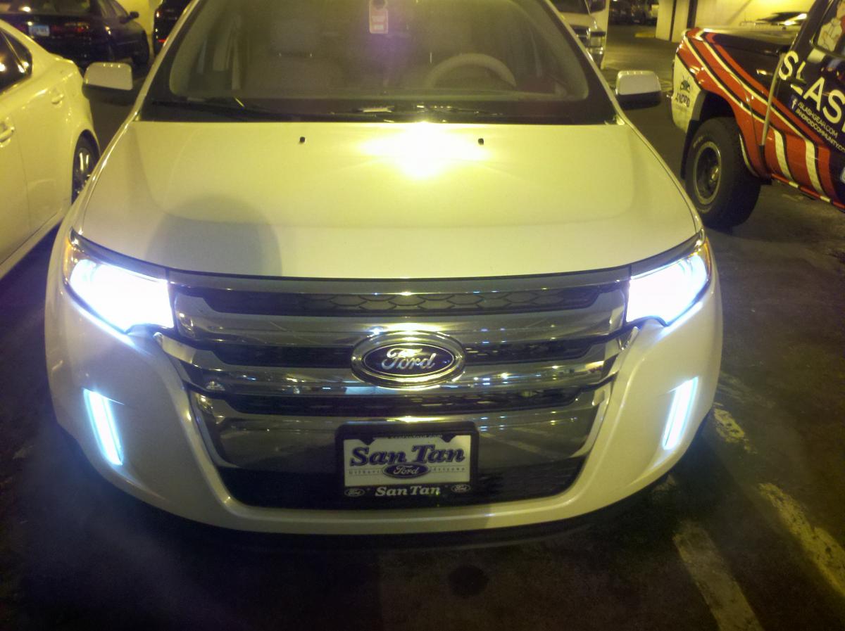

PrinzII Posted June 8, 2012 Report Share Posted June 8, 2012 (edited) This is my 5K 35w HID kit (Low Beam) Note: Pic was taken with a cell phone which gives a different appearance than real life. Edited June 8, 2012 by PrinzII Quote Link to comment Share on other sites More sharing options...
MtnMrksmn Posted February 25, 2015 Report Share Posted February 25, 2015 This is my 5K 35w HID kit (Low Beam) 2012-06-07_17-56-57_137.jpg Note: Pic was taken with a cell phone which gives a different appearance than real life. Looks awesome! think im going with diode dynamics for my soon to be 2013 Quote Link to comment Share on other sites More sharing options...
