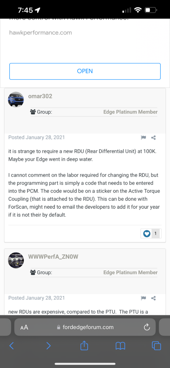

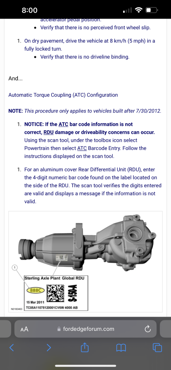

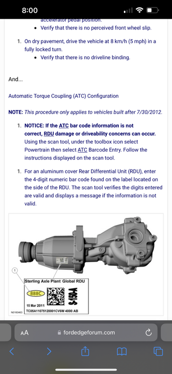

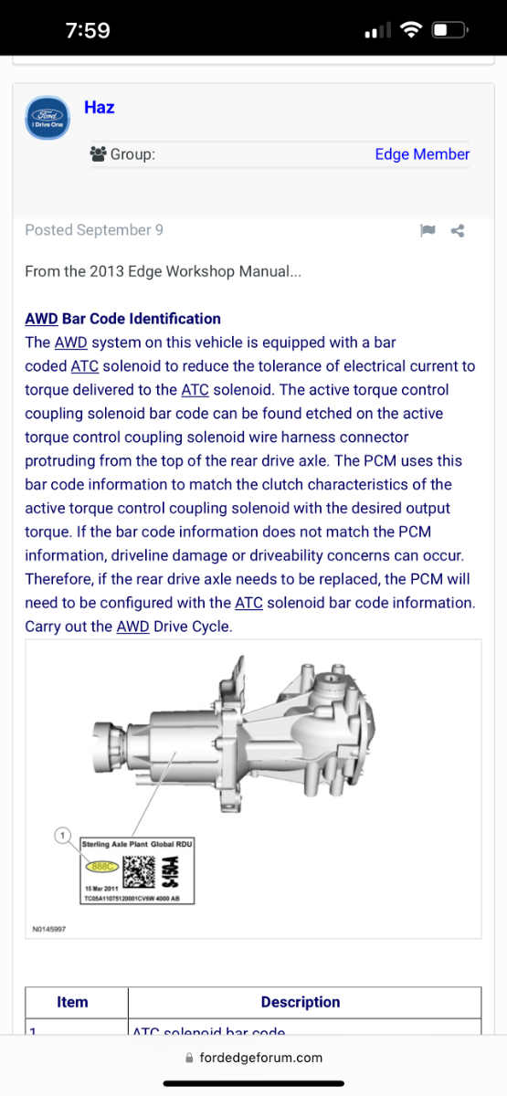

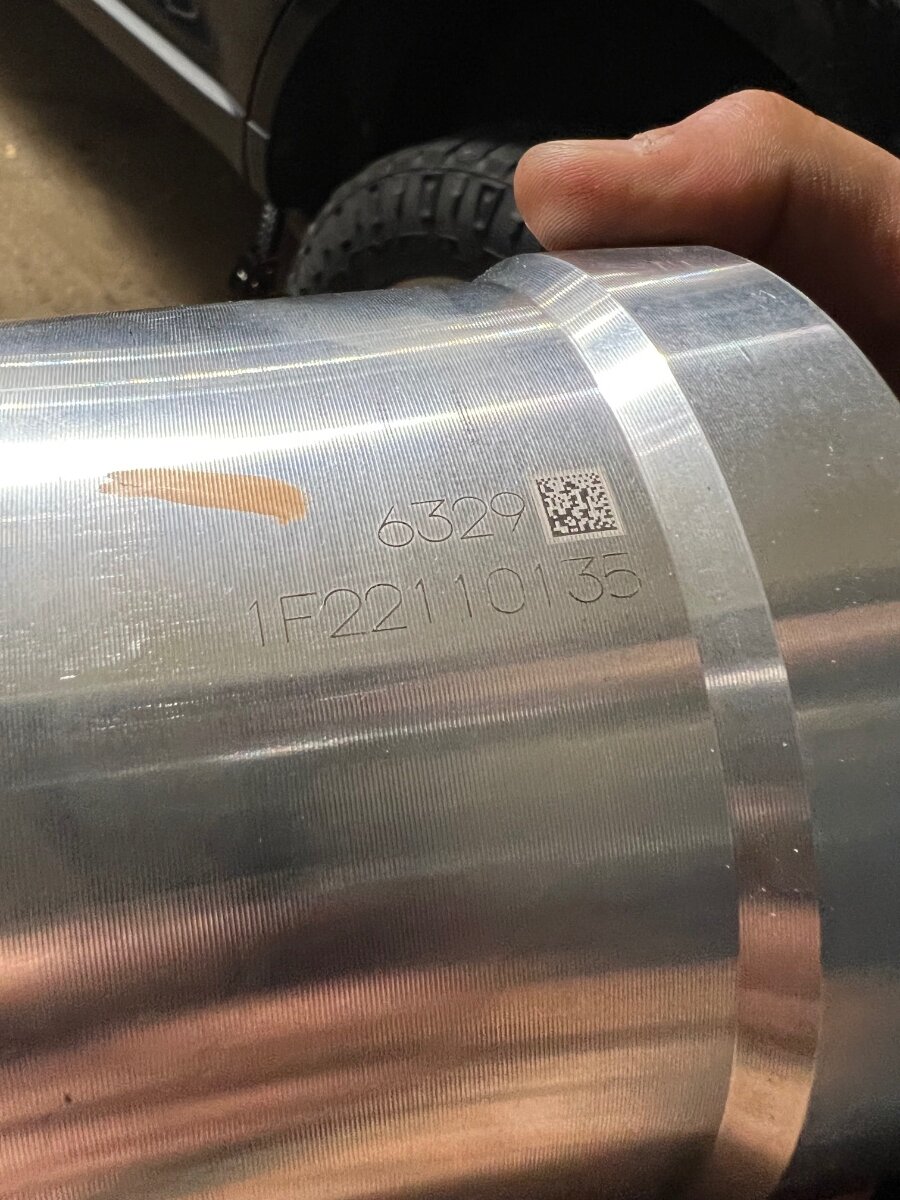

  1. I had the same clutch problems 2 years ago in my 2013 with the same exact symptoms when turning at low speeds, and all noise was coming from the clutch itself. I was able to find the ATC replacement at a dealership for about $700 then I installed it and had to program the new 4 digit ATC barcode to the PCM with forscan. The software didn't have an option to program this code so I had to contact forscan for a custom software version that added this option. I found all of this on various threads in here but have no idea on how to tag those here as I’ve just started using this site. I do still have some screenshots I used to help me through this process.
