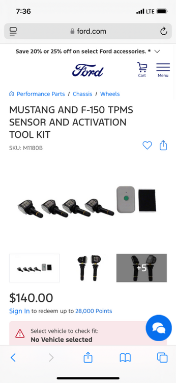

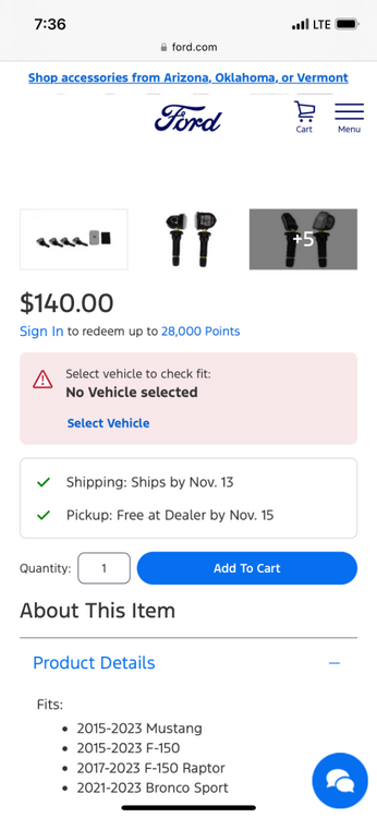

  2. So right now my 17 has a failed TPMS sensor Ford/motorcraft part is tpms35. I found this set of ford performance parts. The Ford edge isn’t listed in the comparable models but the sensors sure do look like the correct ones. Anyone know for sure which sensors are included in this kit? Motorcraft TPMS sensors run about 63 each and well then kit has the potential to save some cash when the other 3 inevitably die.
