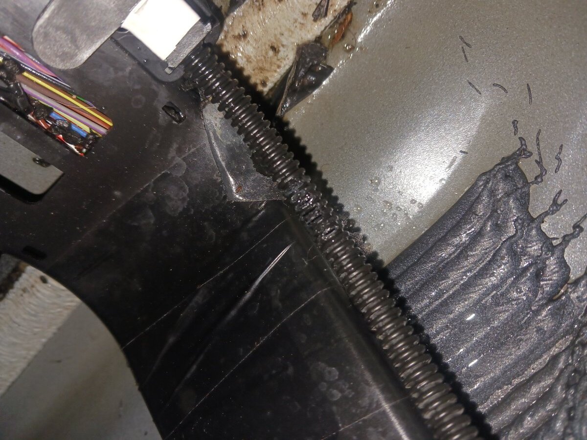

Finally found the problem. Short story is the rear passenger floor was filling up with washer fluid. I found where the hose when it bends to go up from the floor to under the rear seat the hose was worn through. I ended up cutting out the bad section and splicing it with 3/16 brake line. I'm sure I'm not the first and only person that will have this problem.
