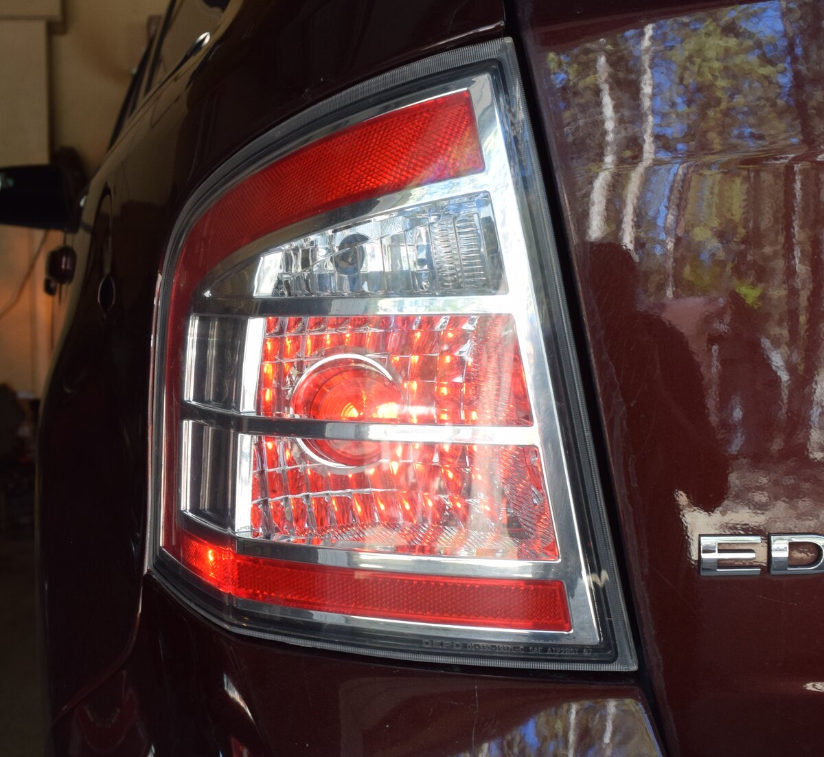

  4. UPDATE - UPDATE . . . . . The converter worked for 3 days and then crapped out. I could not get rid of the hyper flashing. Removed it and went back to OEM wiring for the red brake and turn bulbs. Used one LED and one incandescent bulb per assembly to keep the LED’s from hyper flashing. Ran two hot wires from the front turn signals to the two amber 3457NA bulbs in the lenses in the 2011 assemblies. Ran 16/2 in split loom from the engine compartment under the drivers side of the car. For the front part of the run there was a spare hole in the fuel line supports that worked out just fine. Then above the rear axle on the left side was a rubber wire plug that allowed access to the rear hatch area and the taillight wiring. The result looks good with one incandescent bulb and one LED bulb in the red part of the lens and one amber 3457NA incandescent bulb in the clear turn/backup lens. The flashing amber overpowers the flashing red lights. My goal was met for more visibility at the rear when a turn is indicated. Hodgie
  5. So I got the 2011 taillight assemblies installed in my 2010 Edge. They were $26 CAD each from the auto wrecker. The other purchase was the 2 into 3 converter from Amazon for $21.87 CAD https://www.amazon.ca/Convert-Trailer-Connectors-Converter-Electrical/dp/B0BZJT39Z9 2010 Taillight. 2010 Ford Edge Rear Taillights.m4v 2011 Taillight 2011 Ford Edge Rear Taillight.3gp The 2010 had one 3157 bulb. The 2011 has two 3157 bulbs in the red portion and one 3457 bulb in the amber portion. So triple the lighting power to the rear. I will be buying both red and amber LED's to install in the 2011 lights. I placed the 2 to 3 wire converter on the left side behind the liftgate actuator cover, there is lots of room in there. The right side has a speaker that is in the way. You need to run a new wire from the right side turn signal wire to the converter. Then you need to run 2 new wires from the converter back to the right taillight assembly. One for the turn signal bulb and one for the brake light bulbs. Simple wiring but time consuming as I solder and heat shrink all connections. "Never time to do it right, always time to do it again." In the rear I now have amber turn indicators, red running lights, red brake lights and red 4 way flashers. Well worth the time to do it.
  6. I got it done. The 2011 taillight assemblies fit my 2010 perfectly. I now have red running and brake lights. The emergency 4-way are flashing red. Bonus is the 2011 have two 3157 bulbs, the 2010 only has one. I now have amber turn signals on the rear. I will post a bit of a how to with photos and videos when I get a chance. Hodgie
