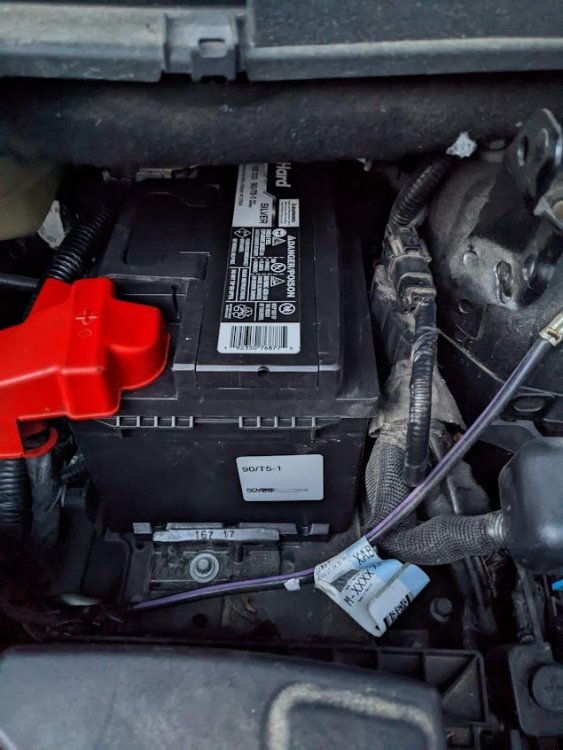

  3. Picture of the wire I mentioned jiggling. It is to the right of the battery and attached to a harness it didn't come loose from.

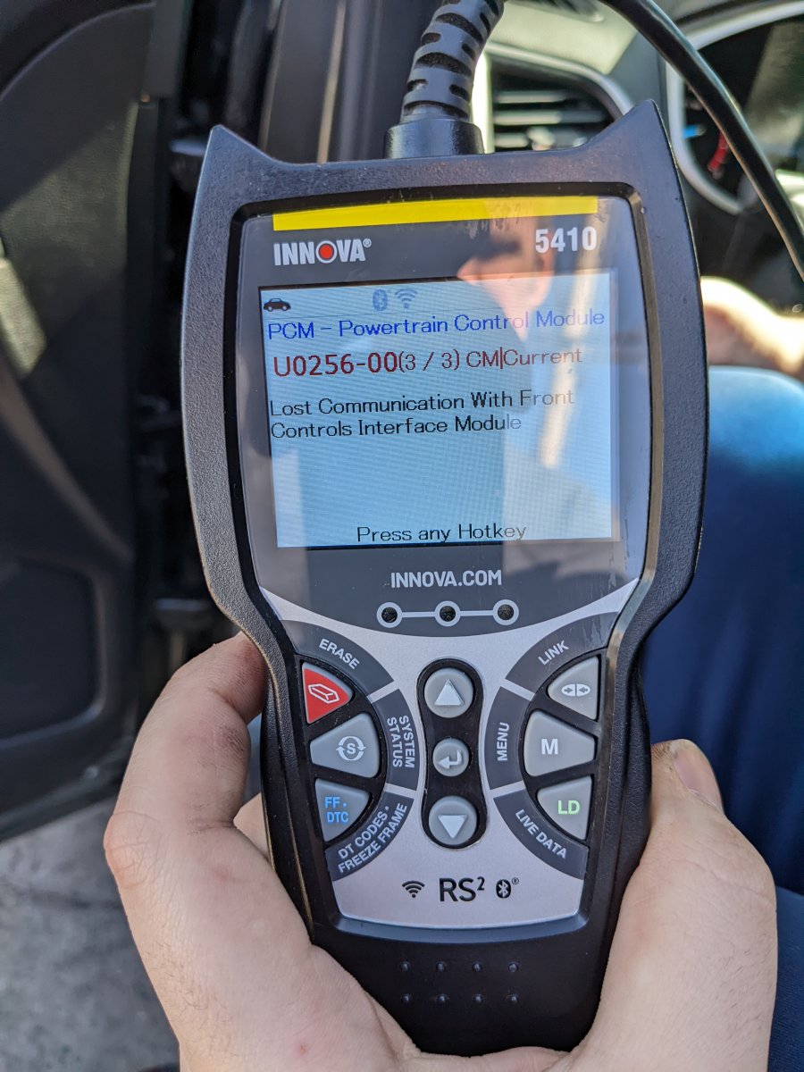

  7. Well I took it to the store and did the reset but, code more error codes like the attached screenshot
