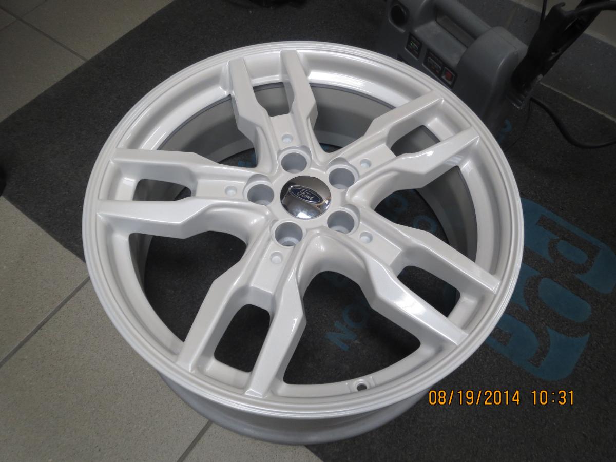

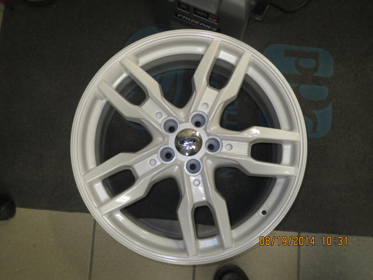

  1. Back from the wheel shop - they look amazing. They did the inner barrels too - they'll be a lot easier to keep clean!
  2. The only pitfall I see thus far, is that the OE center cap no longer 'snaps' into place, as it was indexed off the chrome cap... I'll have to sort out some type of retainer or double-sided 3m tape to affix them in place....
  3. I pried the cap off with a small pry bar. The large glue areas were scraped with a razor blade, then the wheel will be sand blasted before being refinished. I'm only doing the one wheel to start - sort of a PROMO from my wheel company, as they've never done one either...

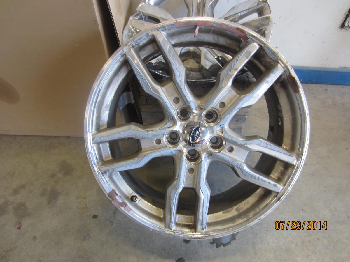

  4. In the process of having one of my 20" Limited wheels refinished. I had a damaged wheel off another vehicle, and was successful in removing the chrome cap. One of my customers is in the process currently of refinishing the wheel now - will post pics when completed. I've taken the route to have the wheel color matched to my Edge - White Platinum Tri-Coat Here is the wheel with the chrome cap removed:
