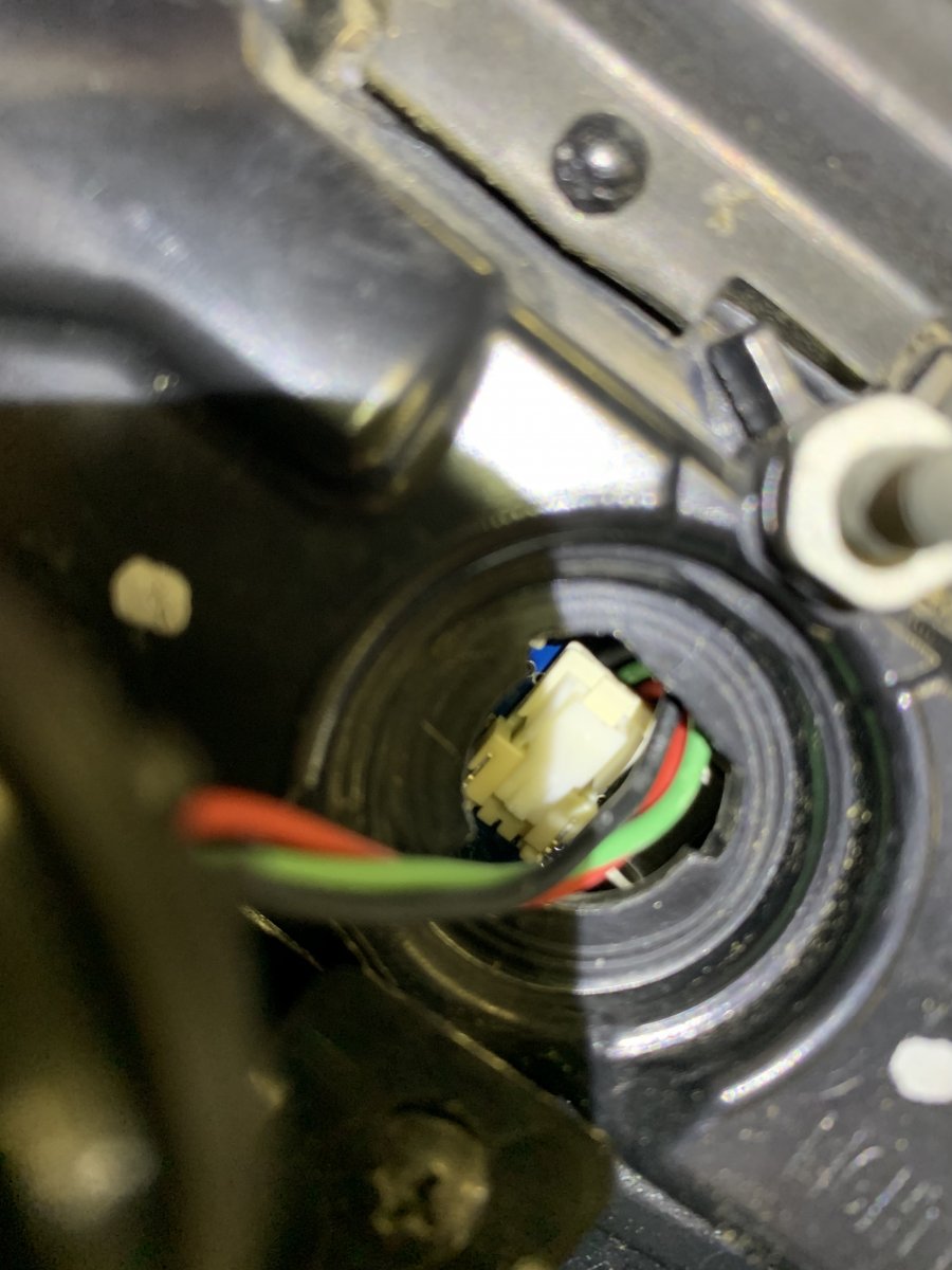

Update: I dried out the condensation with a vacuum and space heater through the access plug in the back. I then ran a thick bead of high quality rtv silicone all the way around where the two halves meet. Let it cure for a couple days. Tested the vent holes in the back with blow drier and they seem to be working. I reseated the access hole plug with some thick silicone grease. This product does not cure and it has a high washout value. The plug is sealed but still able to be removed. The part was reinstalled today and it looks good so far. The part is sealed except for the vent holes. This is the closest I can get to how this part was new. Let’s see if it vents function correctly per Fords design. I did notice a large gap on the top of the unit where the rubber gasket does not make contact with the rear gate under the back glass. See pic. I’ve looked at a few other edges and they all had the same gap. This would appear to be normal? Maybe help the venting process? There is the possibility of water getting behind the light bar through this gap. If the unit still has condensation issues I’m going to fill that gap with silicone to prevent water from running down behind the light bar and making contact with those vents. We’ll see what happens in the rain and car wash. Am I missing anything? Thanks, -

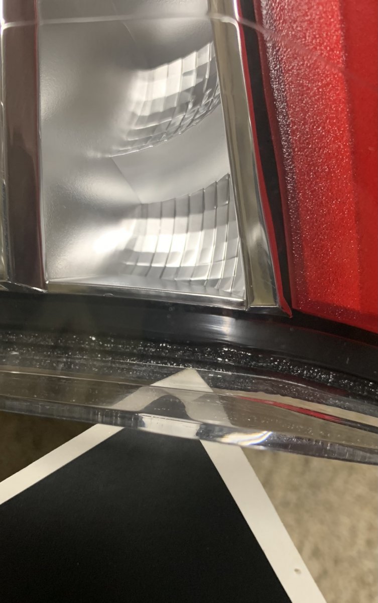

Thank you 1004 and enigma, I removed the part and found a gap in the seal immediately. Right in the area of the most condensation. Whatever adhesive they use to seal the clear lens to the black plastic back has an inconsistent bead. The bead gets real thin in a section and the 2 halves have separated. I’m thinking about resealing the entire joint all the way around with good RTV silicone. I’m sure this will help but I’m not 100% confident this will solve all condensation issues. We’ll see I guess. If not, I like the idea of a couple added goretex covered vents in the back. There is 2 back there already...why not 4 right? I’ll seal it first and reinstall. Maybe it will vent correctly. I would send it back were I bought it, but it’s not new and I bought it a month ago. I saved $600 over buying a new part. It looks perfect but its not. My advice: BUY NEW PARTS I screwed myself but maybe I can fix this thing. see pic of the gap -

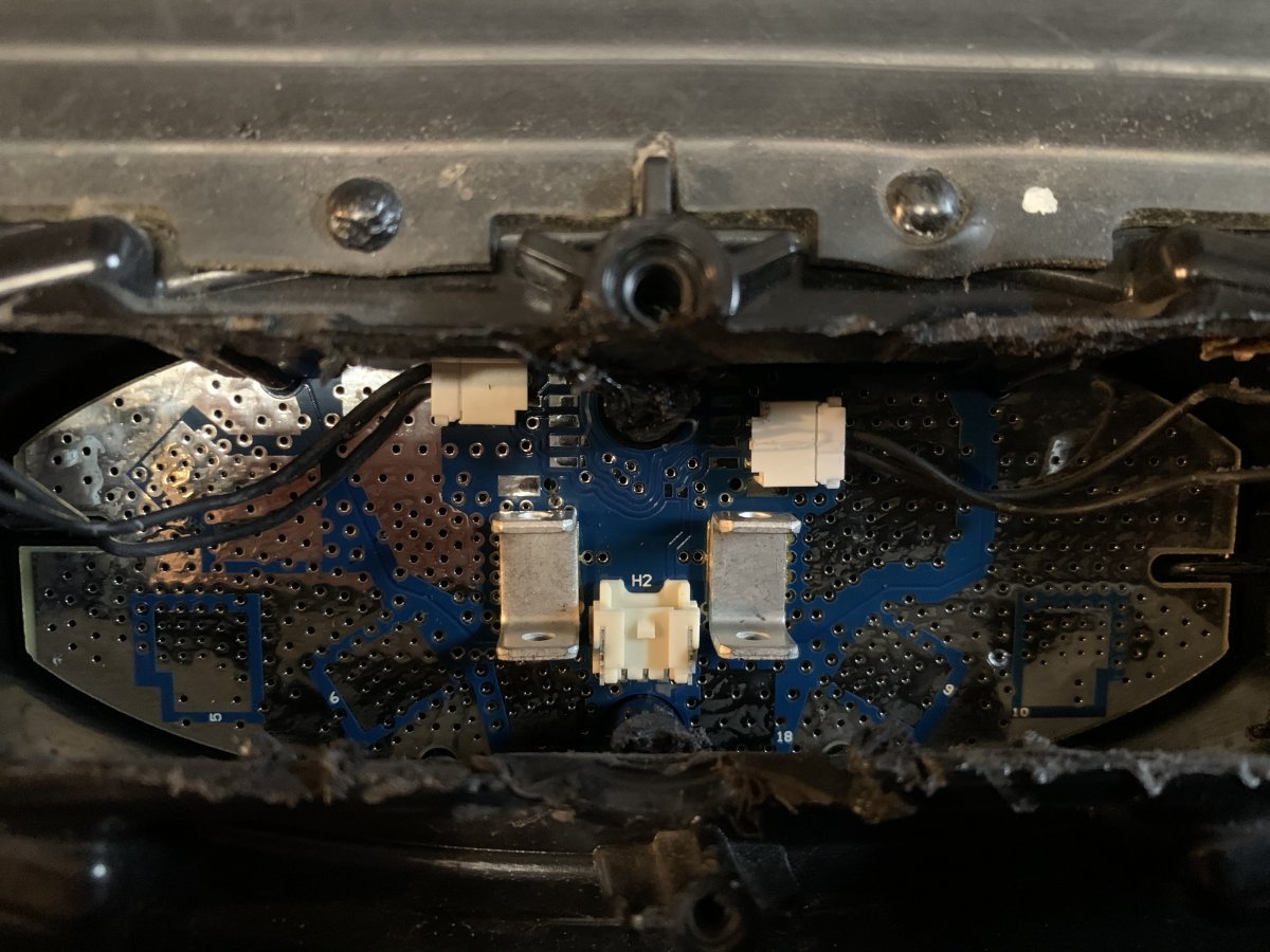

I have attached an image of the internal circuit board inside the light bar unit. I cut an access hole in the back of the unit.There are 2 black wires going in each direction from the top 2 white connectors to the back up lights. The middle empty plug is where the red,green,and black 12v power comes in. That’s it for wiring or components inside. No LEDs running through the red sections of the unit. Any ideas if I’m missing something? I wanted to make sure I could reseal the back of the unit, so I didn’t cut any further. This was really touchy. I resealed the hole with black RTV and it is back working in the edge. I’ve scoured the web for a wiring schematic of this part...not found. I’ve looked at multiple pictures of this part online trying to find differences in the wiring compared to what I have. It’s really hard to detect. I’ve called my local Ford dealership and requested a wiring breakdown for the part. According to the service manager, they don’t have that info. They just install a new parts. I’m at a dead end without a schematic. I did notice one of the three main plugs for this unit has a blank pin filler on both sides of the plug (car side and part side). Maybe this has merit...not sure. If I had more info or really good wiring pictures of the correct part for my rig that would really help. I used to repair pinballs and jukeboxes so I have a better that average understanding of circuitry.
My side tail lights illuminate like a sport or titanium model should according to your pictures. I have an odd situation with my tailgate. Even if I purchase the correct light bar, I don’t have the wiring to make it work. Ford put an entire lift gate for a SE/SEL on a top sport model? Bizarre. Nice quality control at Ford.
Update: Upon further investigation, my light bar does not have lights installed. Either it was like this from the factory, or a previous owner replaced the unit and went cheap. Also, the wires leading to the tiny board inside the unit are for the back up lights. Bummer. enough time spent. thanks everyone for your input
