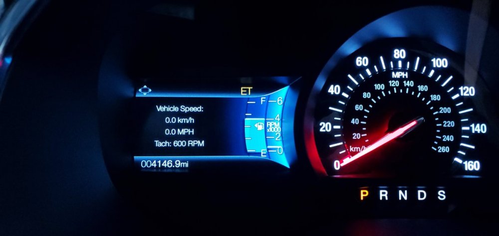

Before starting the vehicle press and hold the OK on the left, start the vehicle and keep OK pressed until the menu is displayed (should be around 5 seconds or so). The downside is that you can't get out of the menu or to any of the normal menu's until you turn the car off and back on.
I finally remembered to try if getting into the Test/Diag menu worked the same as my Focus ST did and it does. I was really hopping to find what gear was being used, but that wasn't available. I did find a screen that shows the speed and RPM as a digital readout though (attached photo). Since I was able to now see the number for the RPM I did a quick test around 35 mph on the way home looking at the difference between 2nd and 3rd and using this I could see a small drop in RPM. So maybe there really is no problem and it's just a poorly designed gear ratio setup (some may disagree, but 3rd gear is useless and shouldn't exist).
