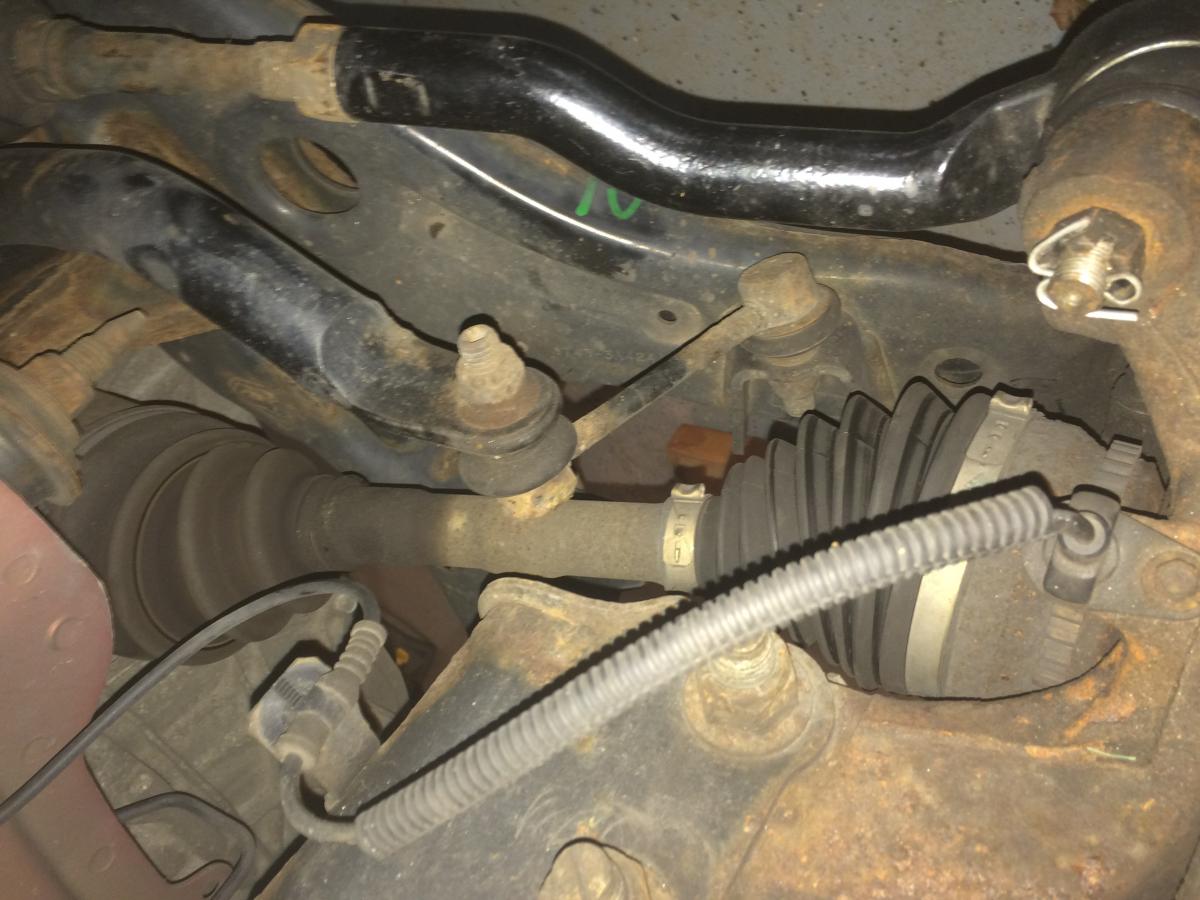

  4. This is looking straight up from the passenger side. I'm pointing to where I believe the rupture to be at. I retraced my trip home and there is a trail of oil the entire way back.
  5. My 2008 edge fwd had its power steering line rust through and rupture last Saturday. Luckily I was a mile from home and pulled into the drive as the fluid ran out. Im in Atlanta so irma has put me on hold the last few days. I believe I can feel where the line ruptured. It's directly underneath the car and I believes a metal component that rusted through. I just can see where it connects and ends. Oreillys sold me the high pressure line but I don't see where either connection would be. I'm thinking it's actually the return line, but when I look at those they just seem to be a Hose going back up. So the question is what piece am I looking at.
