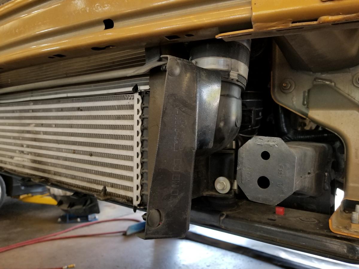

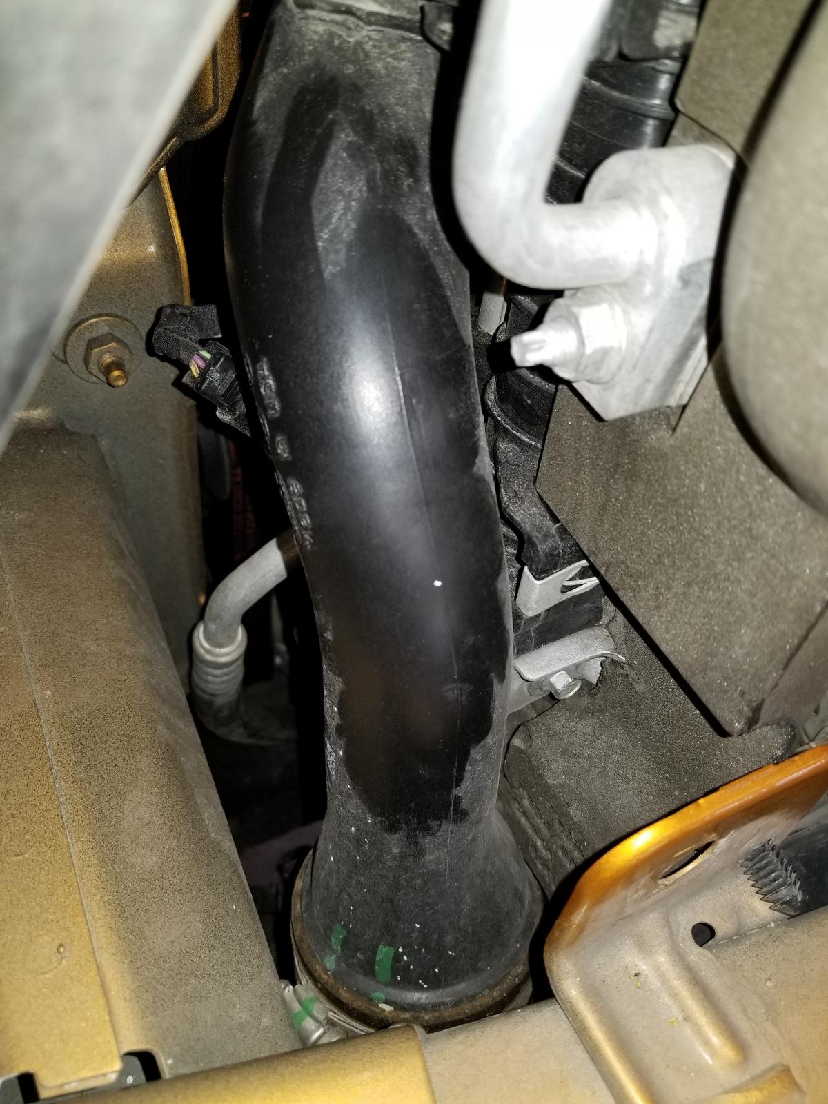

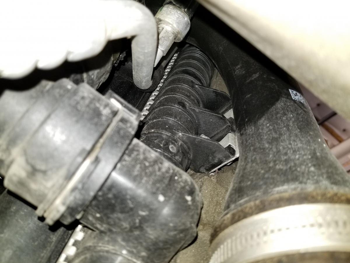

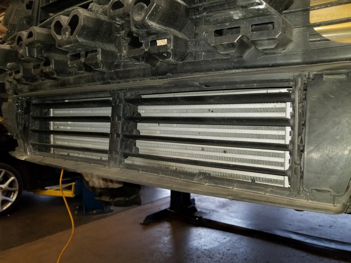

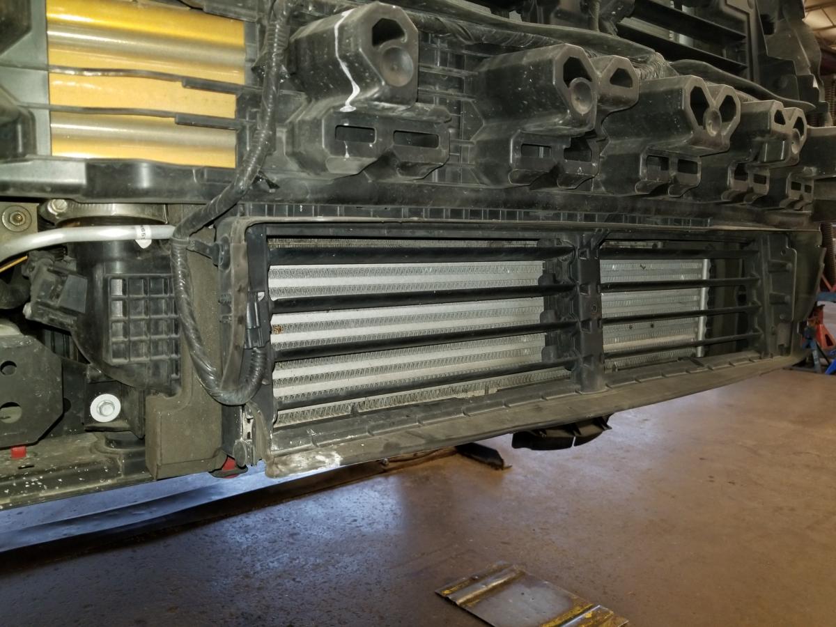

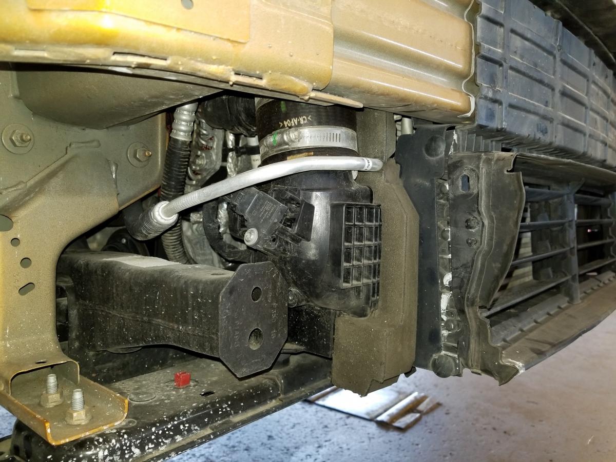

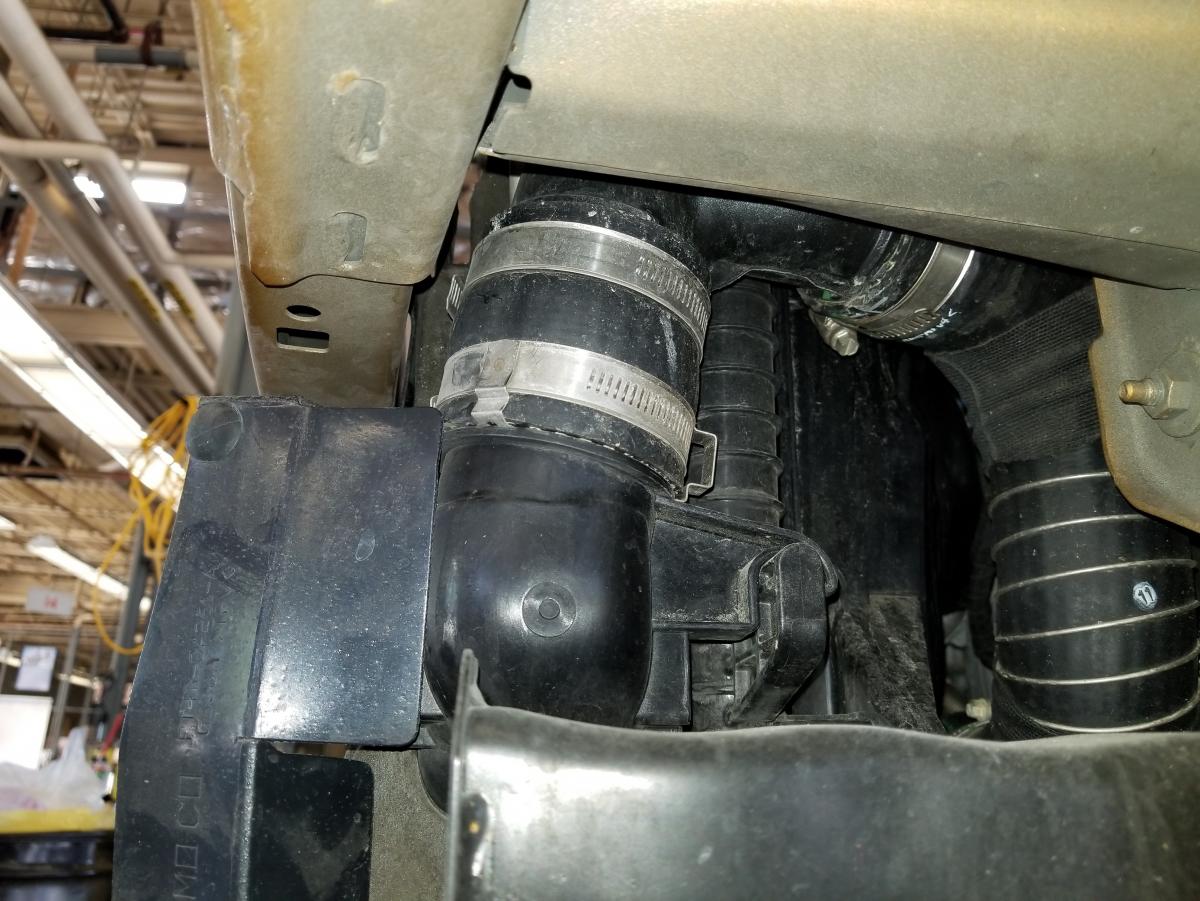

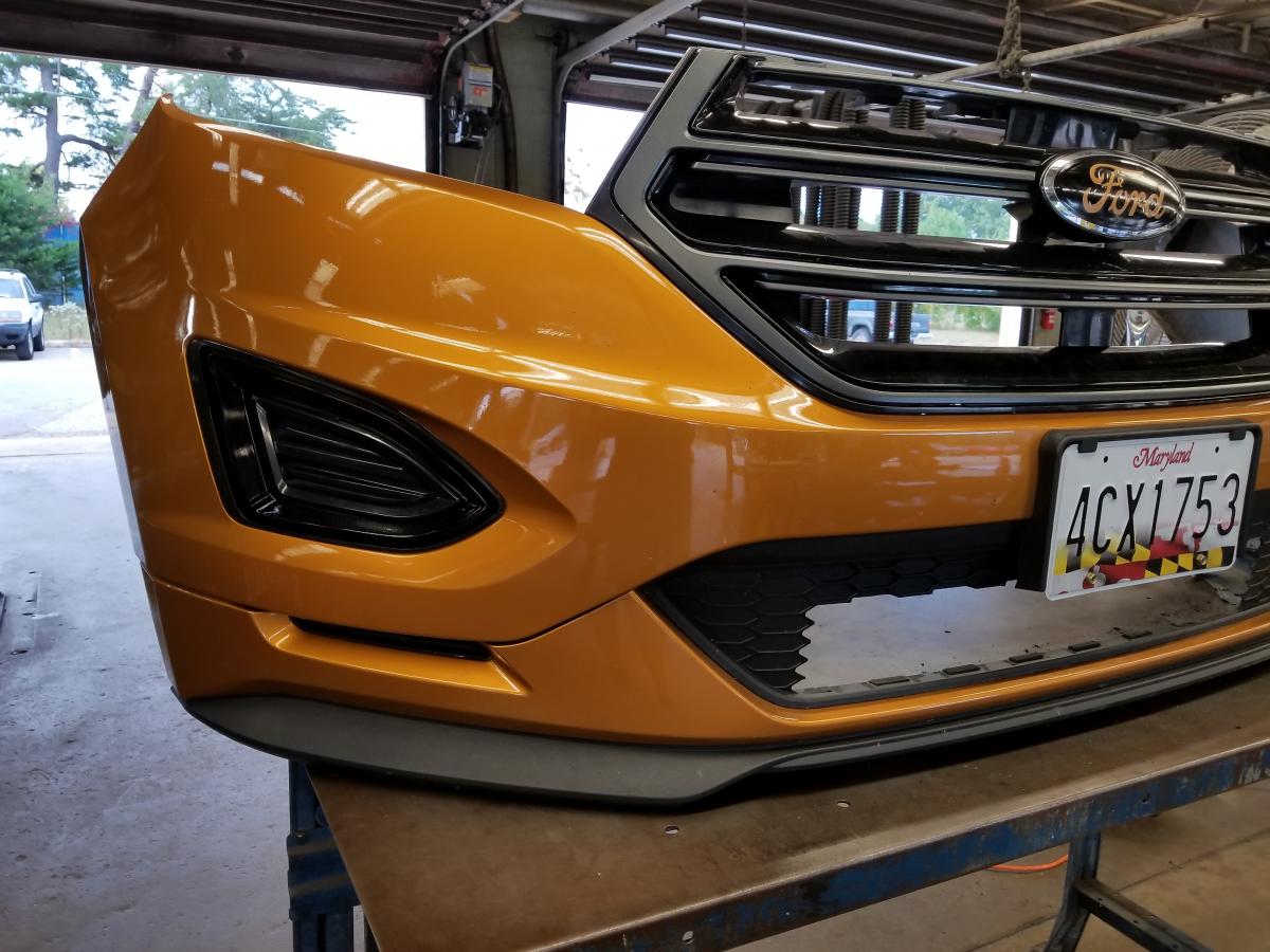

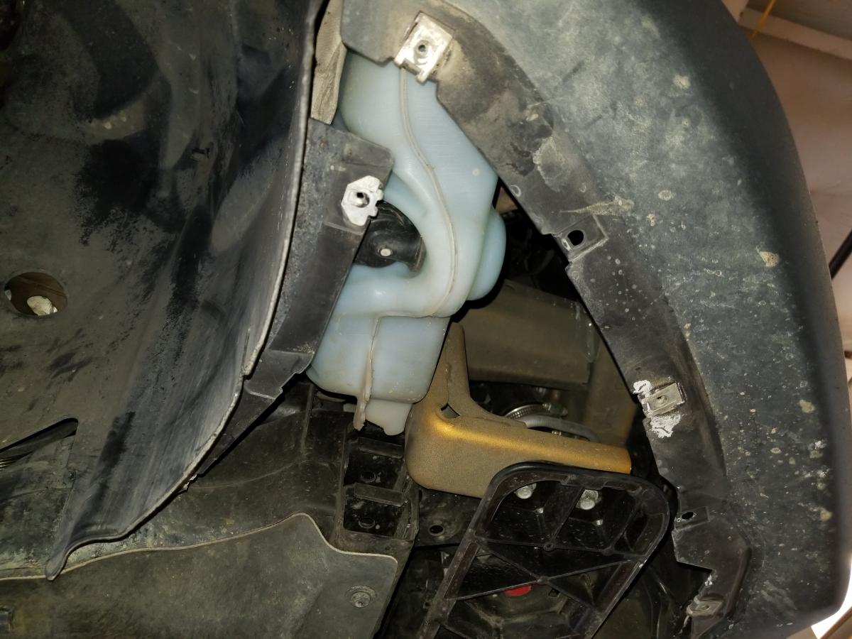

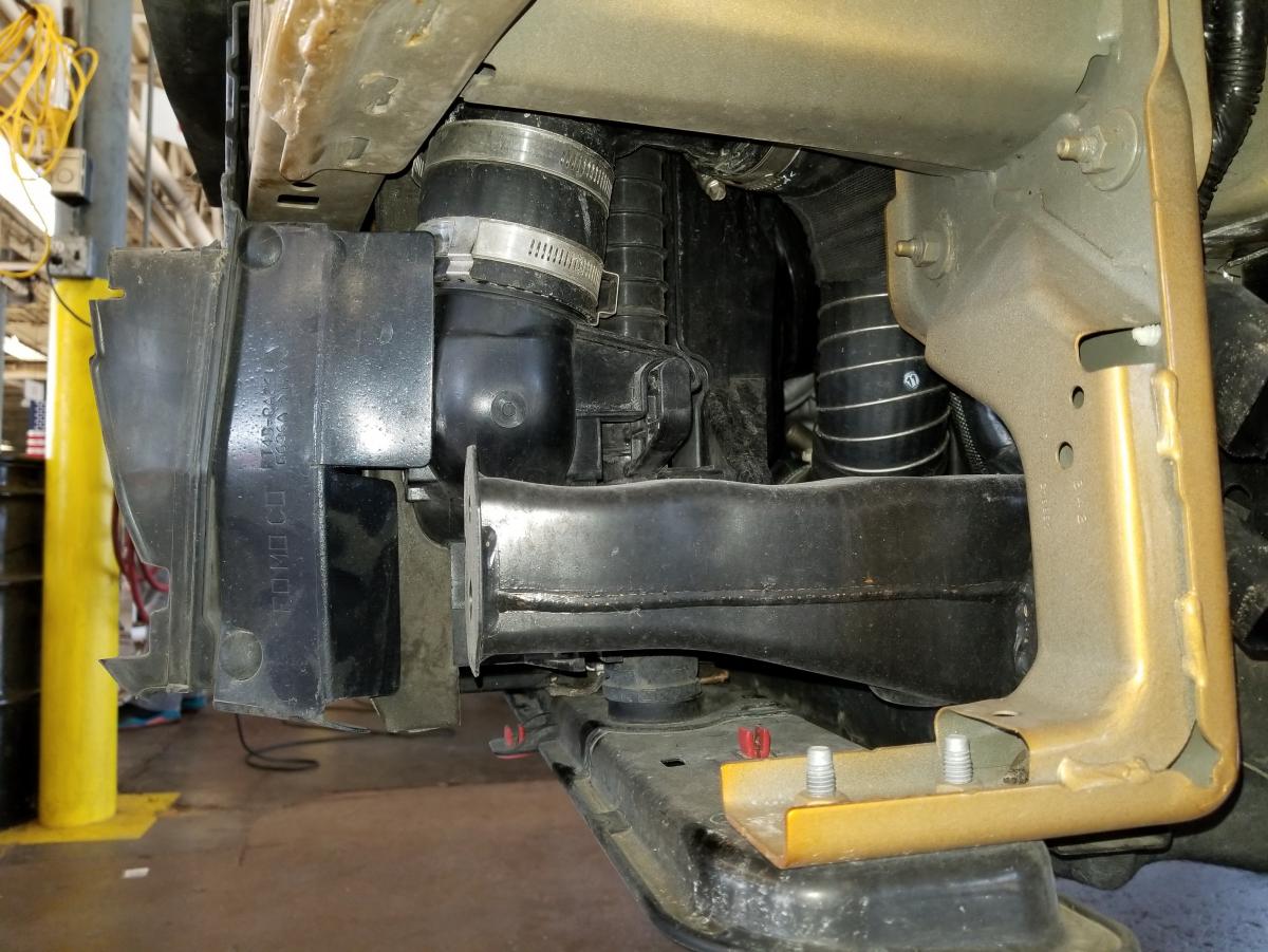

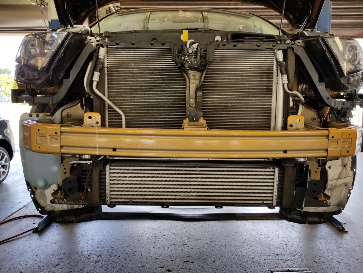

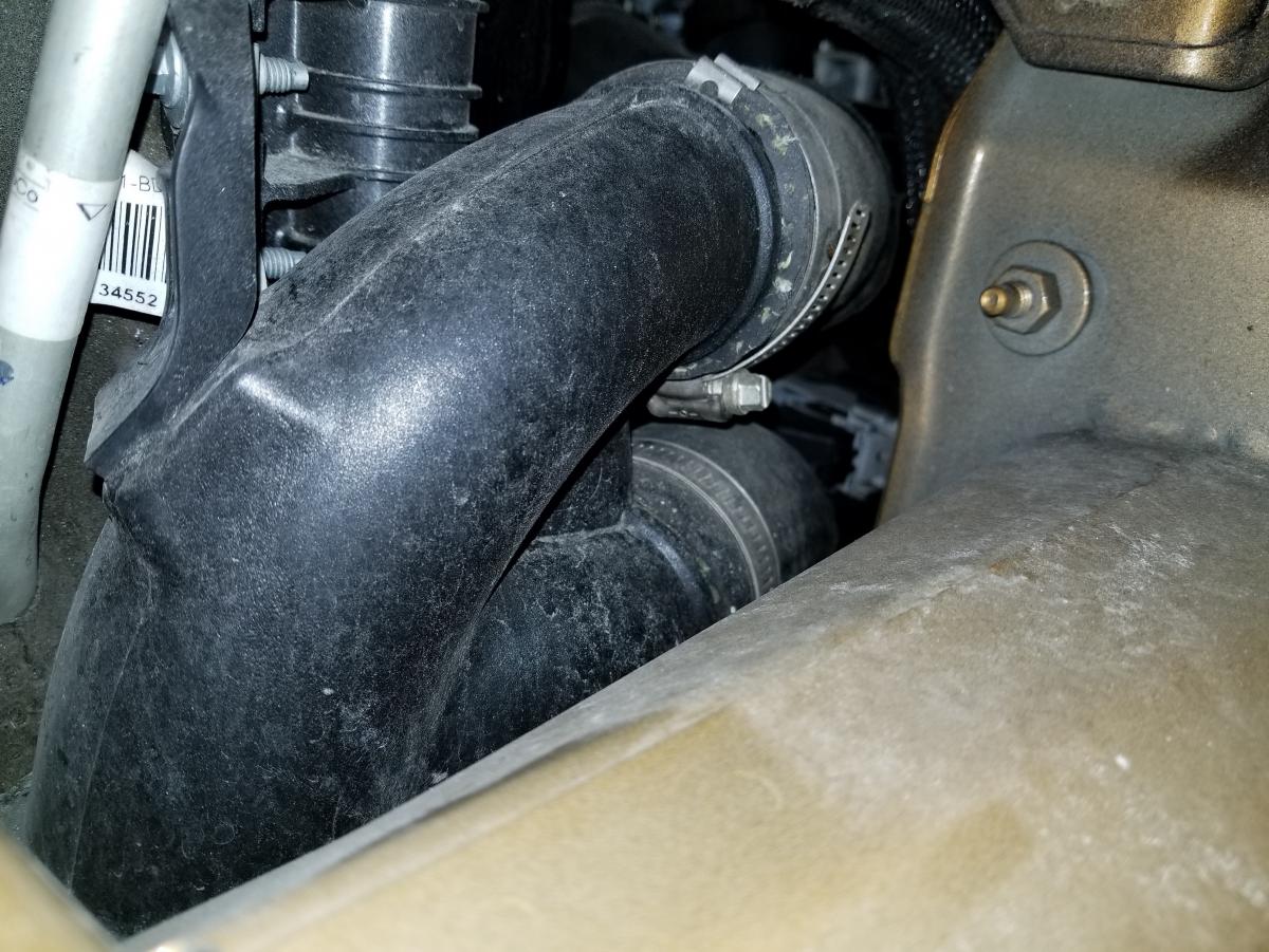

	Since many have been requesting 2016 Sport IC Pics and are anxiously waiting here's what our IC R&D session provided Pic wise:

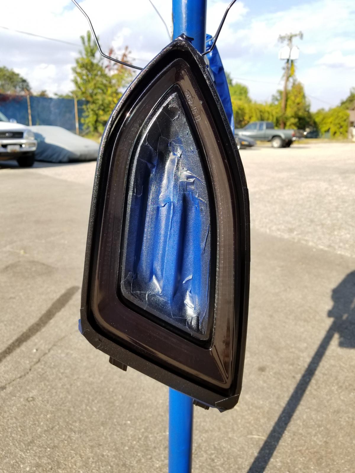

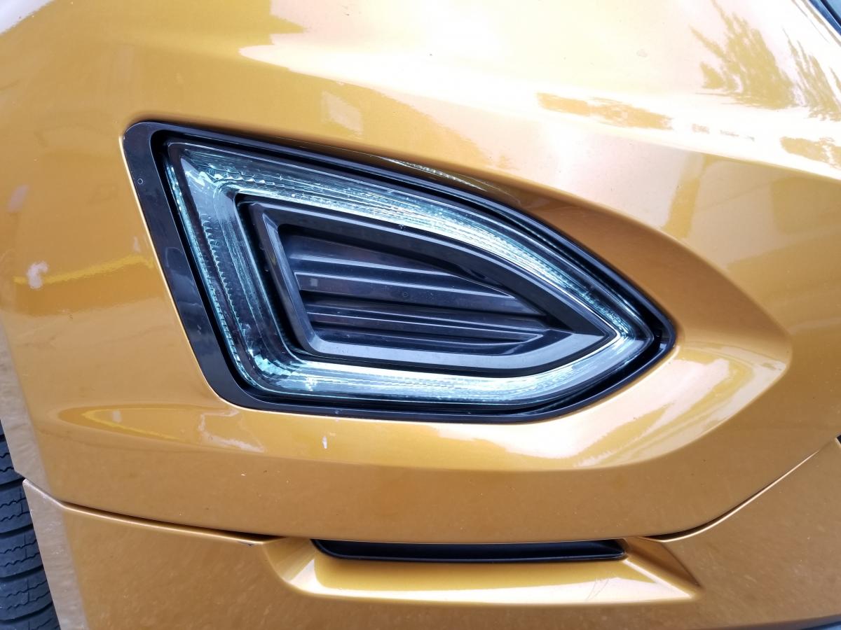

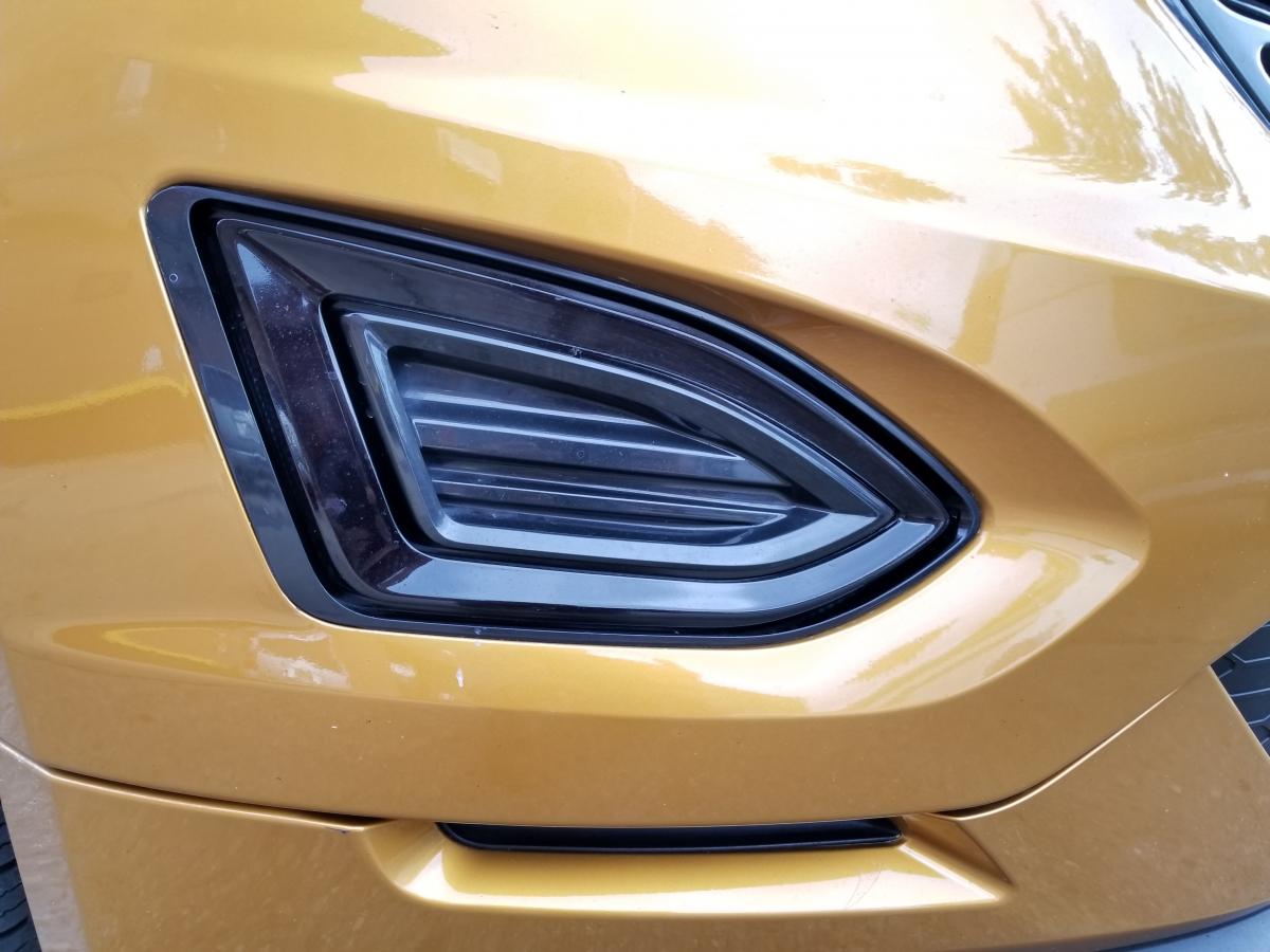

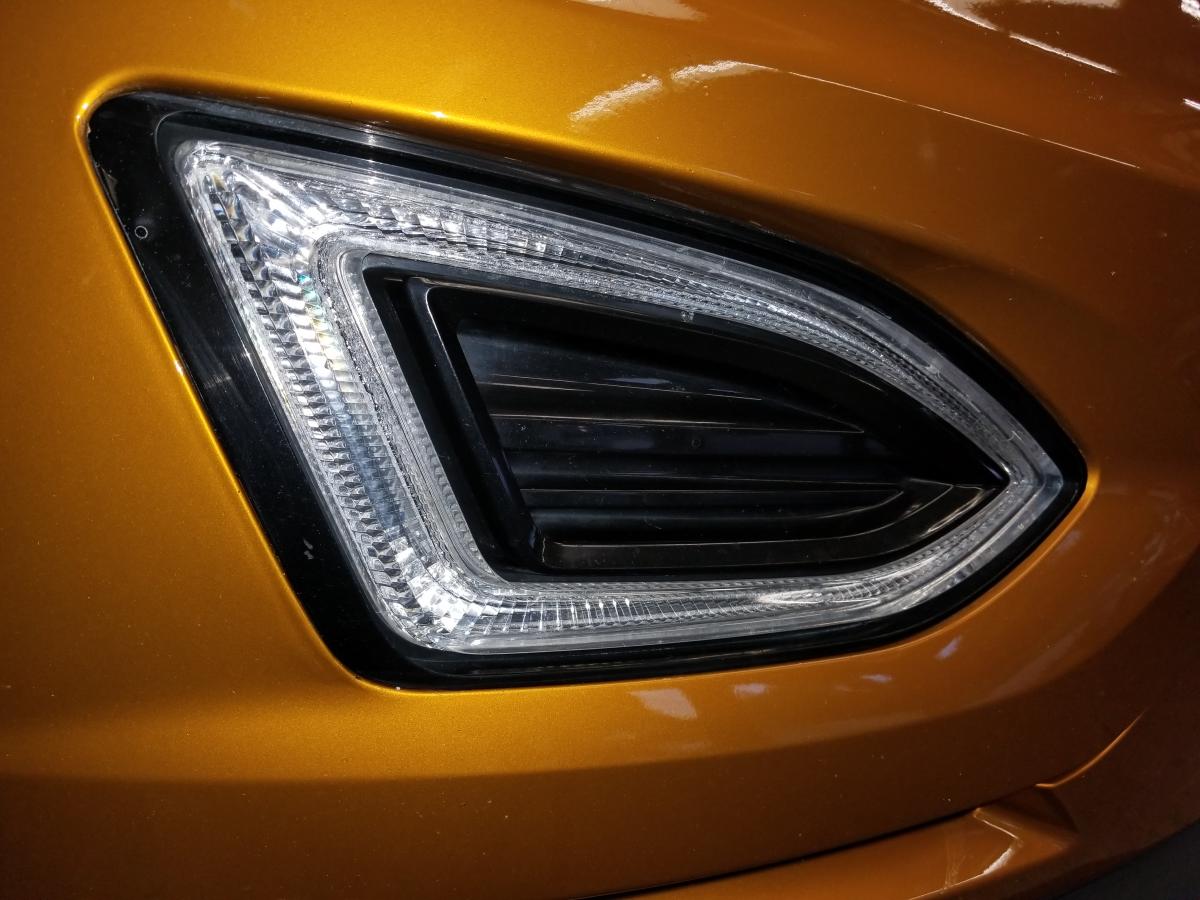

	  Daytime Running Lights (DLR)snmjim replied to snmjim's topic in Glass, Lenses, Lighting, Mirrors, Sunroof (BAMR), Wipers To access/remove the Day Time Running Lights (DRL) on your 2016 Sport you will need to remove the front/facia which takes all of 30-45 min once you know how. Ref ??? I removed my DRLs for the purpose of spray tinting since after careful examination noted that attempting to tint with overlay wrap was not going to workout to look good given my overlay experience of nill. So spray tinting was the choice. I used VHT Nite-Shades (Ref Pic). They recommend no more than three coats but I opted for 2.5 even moderate coats and got the affect I wanted (Ref Pics), Clean surface with alcohol or any cleaner that doesn't leave a film i.e. lighter fluid. Tape off. Hang up in a dust free environment, with Temps & humidity in the manufactures recommended range. Spray one coat at a time evenly with 15 min between coats There you have it...da, da daaaaah!... 2016 FORD EDGE SPORT DAY TIME RUNNING LIGHT.pdf

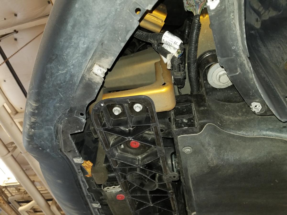

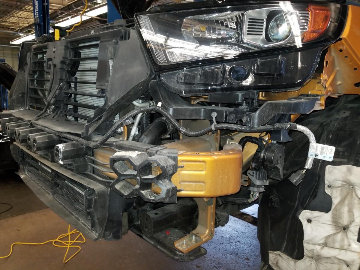

	  2016 Edge Sport - Removing Front and Rear Emblems HELP!snmjim replied to roots57's topic in Accessories & Modifications Special K & I just last Wknd R&D the front of our 2016 Sport and found answers to multiple topics on the forums. In this case there was question as to what's holding the front emblem on and can it be removed while on the car and what's holding it on. They say a Pic is worth a thousand words so here's the simple answer, no it cannot be done without pulling off the front. However, we're in the process of authoring several how-to documents with Pics that we'll be posting in the near future... As I said before...most of us have jobs and have to fit this time consuming effort in so be patient...
