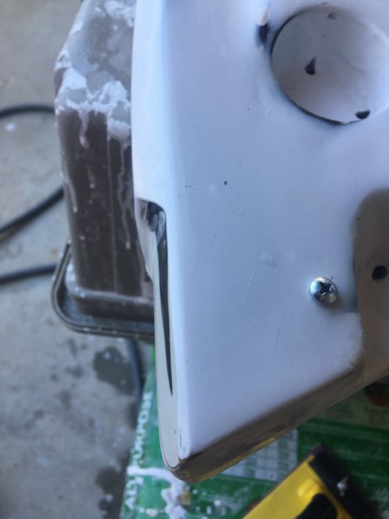

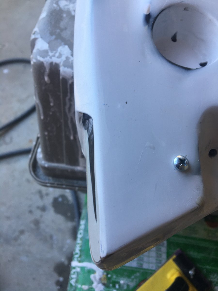

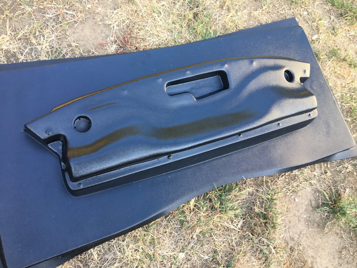

  1. Making progress every day, and pricing will be settled in very soon. The first black one has been molded and is ready for trimming and drilling. The screws did their job and made clear center marks for drilling the rivet clip holes, a huge time saver. Hopefully, it will be done and installed by tonight.

  6. As long as I had the mold at home I did a few tweaks to it. As you know I added the screws to locate the holes then I tightened up some of the tolerances for an all-around better fit, and last I adjusted the wings to be more distinct and line up with the body panel better.

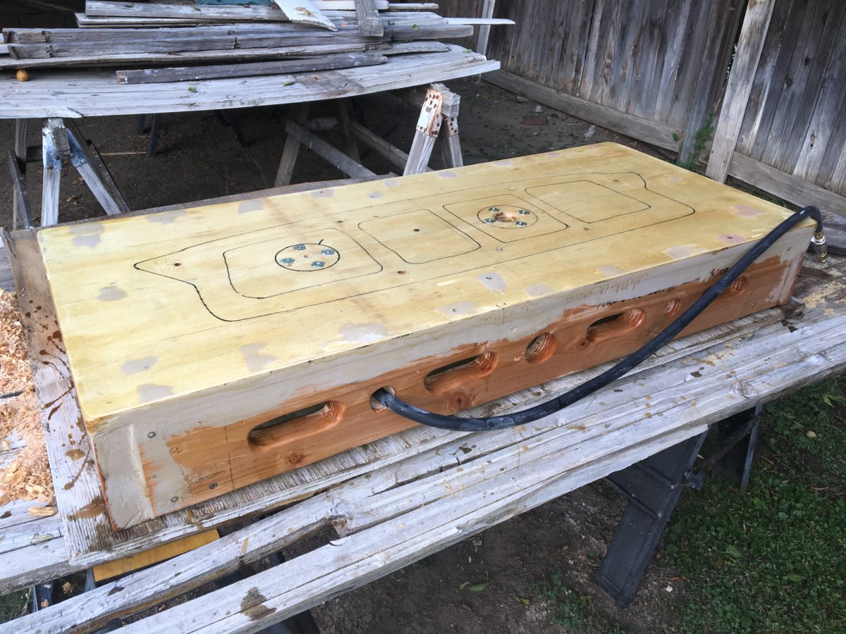

  7. Just finished patching the wood frame and gave it one heavy coat of varnish. A few drips, but they will sand out and the varnish is not on there to look good, it is to seal the wood grain and add some strength to the plywood-veneer. The good thing is that the mold will be ready when the carbon material arrives next week. I will be relieved when all the work is done on the mold, It seems like there is always just one more thing to do.

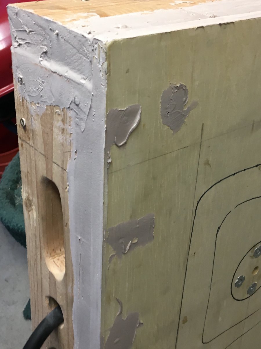

  9. When I picked up the mold today from the shop, they had tape over every gap and over every screw head of the wood base. So I filed all the gaps and covered the screw heads with Bondo putty, it will take a couple of coats and more sanding to get it smooth and ready to varnish. Apparently the vacuum is so strong that it lifted some of the unfinished wood into the hot plastic, so I am going to have to varnish the wood as well. All this has to be done and put back together ASAP to get the samples done before the shop goes on Christmas break from December 23, 2020 to January 4, 2021. It will be tight but it is possible that Santa could bring me a Carbon Fiber intake for Christmas.
  10. Omar302, I took the mold home from the shop for some tweaking, and to add the hole marker screws. The screw heads will make a little bump on top and a little indention on the backside that I can use to guide the drill. Hopefully, the placement of the screws are spot on... We will see on the next intake just how accurate they are, if necessary they can always be adjusted.

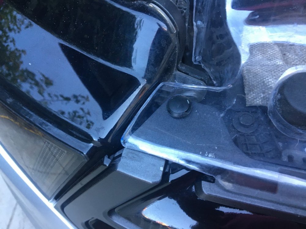

  22. It fits.... and the hood closes. I am over the top happy with the results. With the first one being transparent it was clear that there were no interference problems..... LOL In this photo, you can see how the holes line up for the hood release and bump stops. The cardboard shows where the air enters then moves across to the snorkel.
