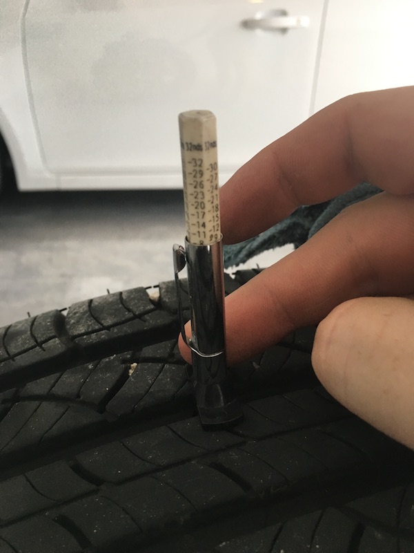

Located in Orlando, FL. Willing to drive up to 1 hour to meet someone. I have a set of 18" wheels and tires from my 2015 Ford Edge with less than 10k miles on them. Wheels are in excellent condition, tires are OEM Michelin Latitude and have 8-9/32" tread depth left, OEM TPMS sensors and center caps are included. *SOLD*
