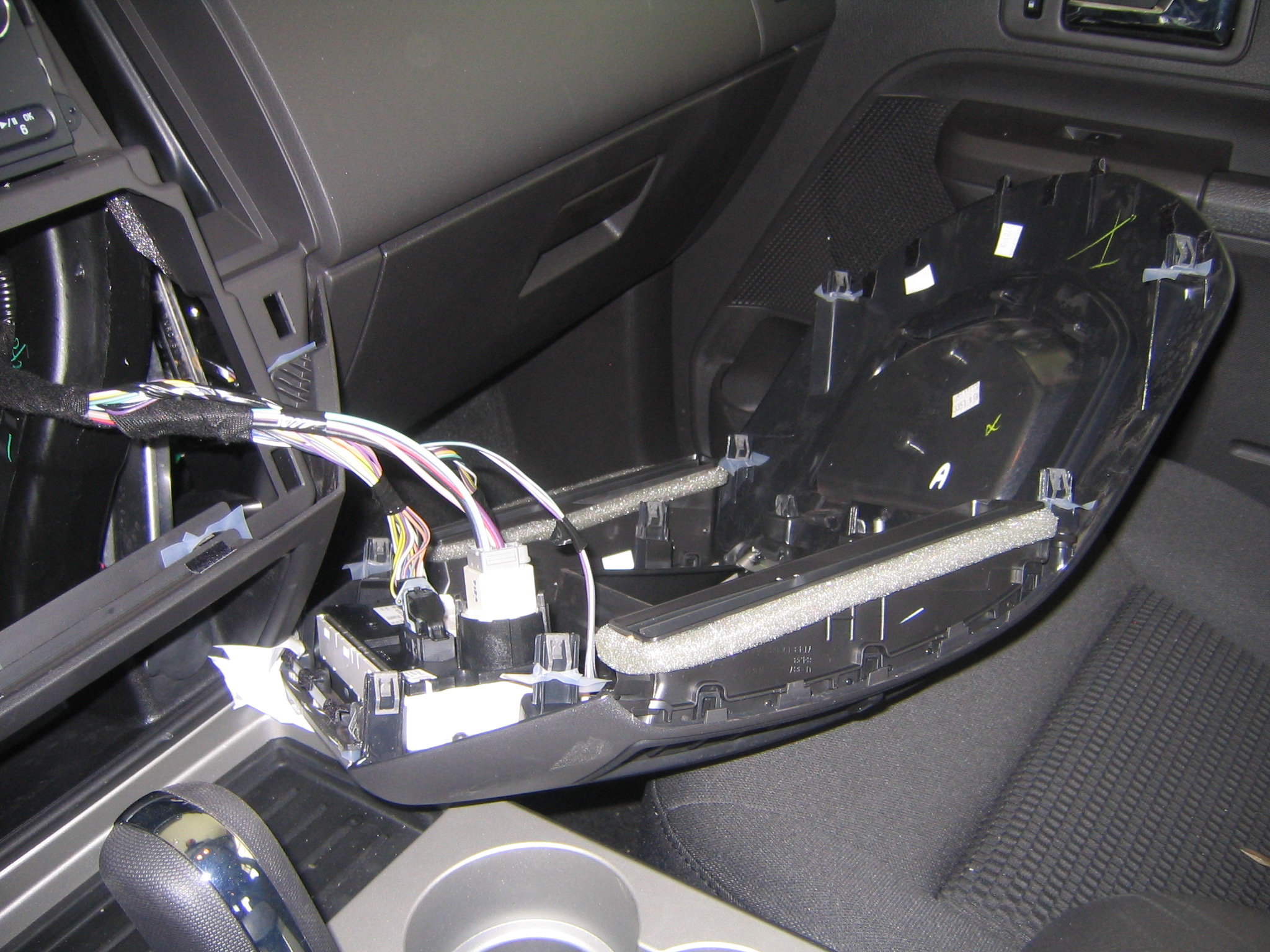

As far as the in and out, it is held on by pressure clips so it literally pops off and pops back in with ease. Take a flat head, if you are worried about scratching cover it with a washcloth from the kitchen, ease it in behind the silver piece at the bottom about an inch, pull out and it should pop out. It is one big piece all the way up to the rubber pad at the top on the dash. Hope this helps. -

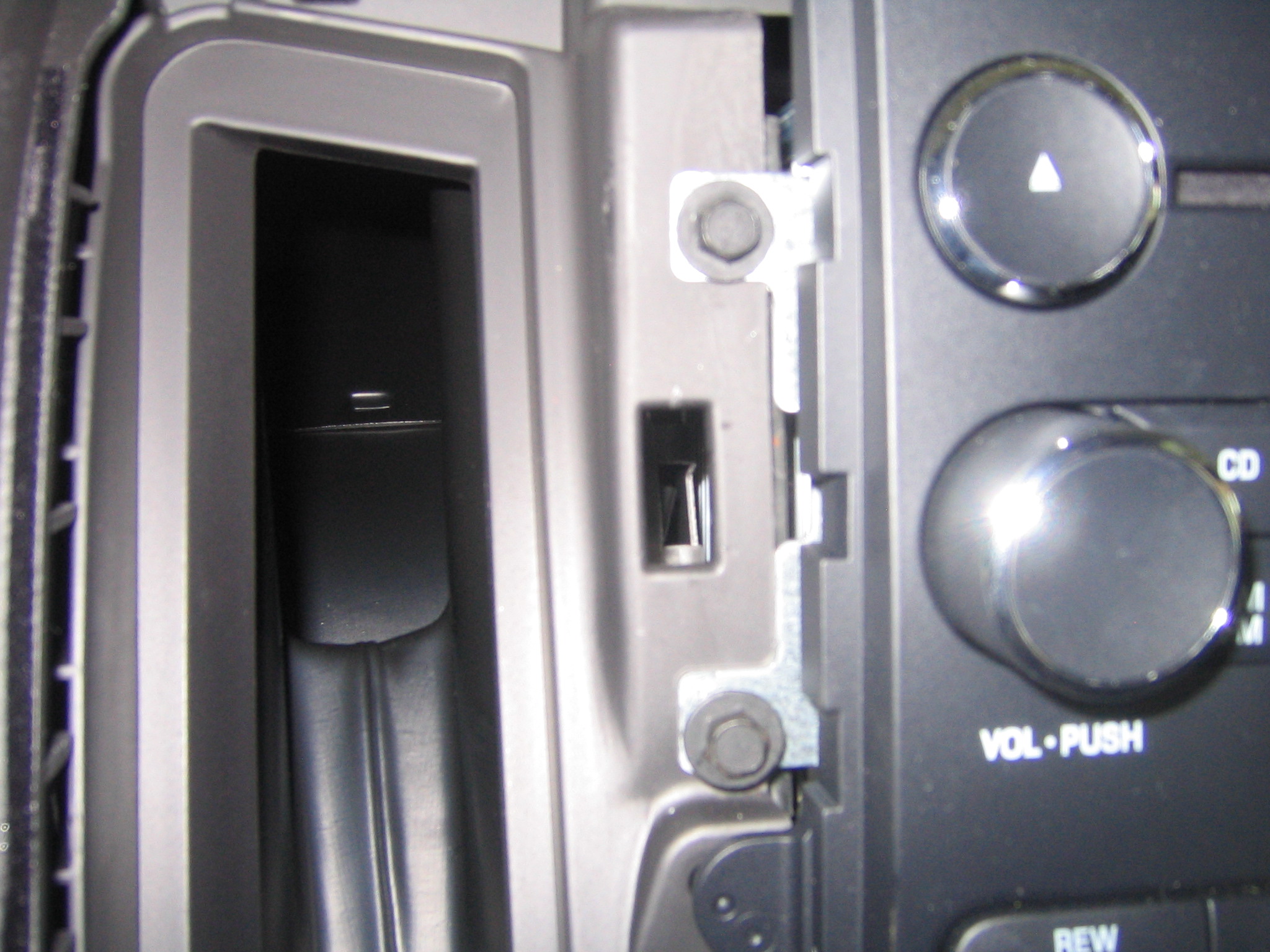

It is a little hacked, but I could not get a drill in the space provided by the removal of the heating controls. I have a dremel tool to clean it up a little. I just wanted to get it together and working for my wife to take to work tomorrow. -
New to the Forum. Just wanted to post a few pictures of my the new head unit in my wife's edge. I have been installing car audio on the side for the last 17 years and this is by far the easiest car I have installed a head unit in. I am anxiously awaiting my headrest dual DVD players. I will post the pictures when I get them installed. As for the install, what a breeze. If you do not know the radio cover/heating controls comes off in one piece (way to go Ford engineers). A simple tug at the bottom with a flat head and poof! Four bolts and the head unit is out. A crutchfield adapter, etc. and it's finished. I made a few modifications to the storage compartment. :happy feet:
