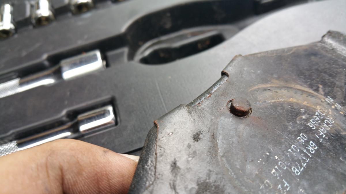

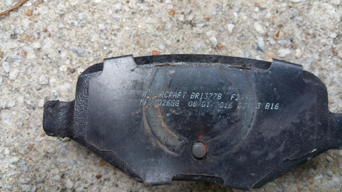

Just wanted to give update on the noise coming from brake caliper. its almost a month later and no noise and parking brake now engages properly. So it was the nipple on the brake pads not properly seated that caused all those issues. -

Macbwt, Thanks for info. I took the brakes apart and inspected more carefully. i have notice on the brake pad nipples had some discoloration on it and notice the same thing on the caliper plunger. it looks like the nipple was hitting the side of the caliper plunger. I adjusted it plunger and reinstalled the brake pads and so far, no noise. I will continue to monitor it and see if the noise returns and hopefully that was the problem. thanks again for the help. -
