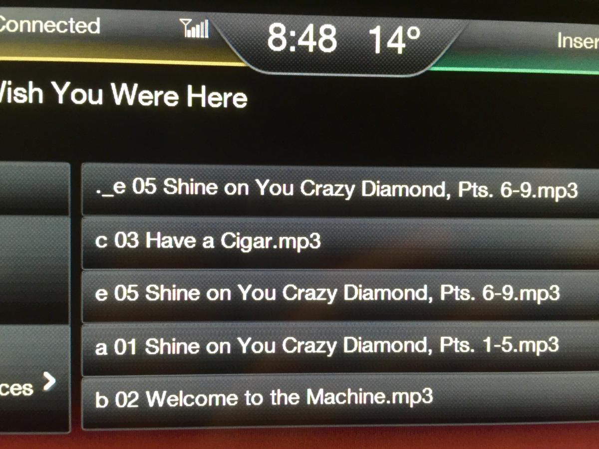

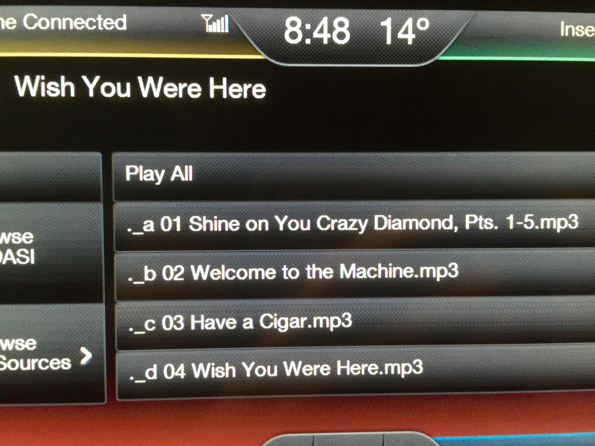

  2. Hey, I've got a USB with hundreds of albums attached to Myford Touch, all mp3's and as far as I can tell, all got a correct tag (using TagEditor on Mac). For some weird reason, all (!) the tracks are in Alphabetic order and not by track number. How can I arrange it to play an album as intended to by played ? Cheers for your help.
