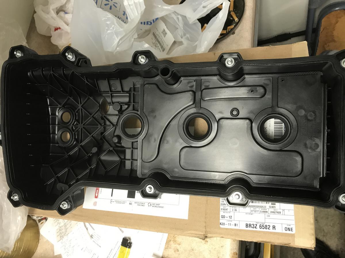

After finding oil in the air filter of our 3.5L 2011 Edge, i purchased the updated valve cover to fix the issue. Replacement was easy, besides keeping all of the wires out of the way. This is not a How-to as FordTechMakuloco has all the information on YouTube. Simply posting some photos of the inside for those interested. I could not tell any physical difference between the 2 parts. Part number - BR3Z-6582-R
