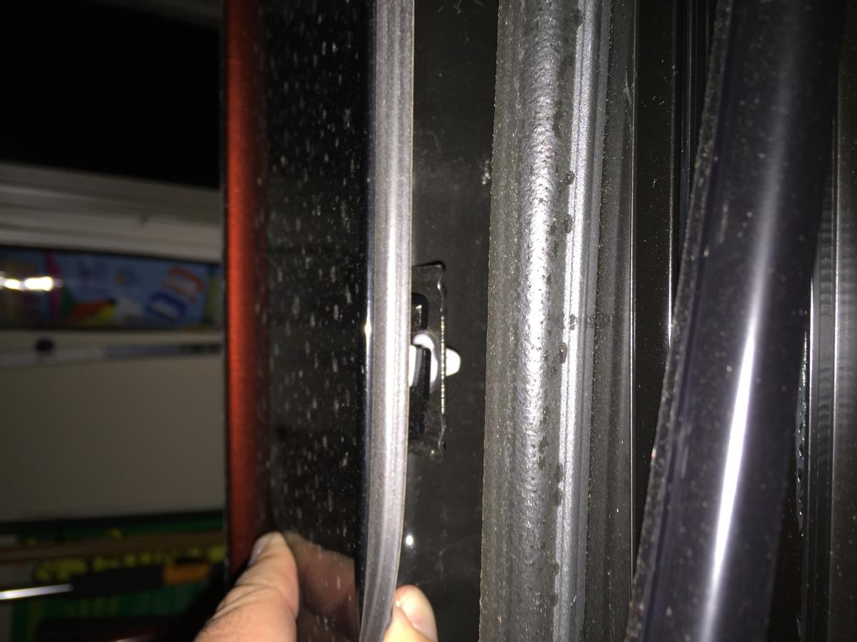

I simply do not have the time to go to the dealer at the moment. I have taken out two of the magnets and can say it is not them. And although the exterior filler panel is missing at least 1 clip, I put cardboard under it and can say that is not the culprit either. I'm focusing on the cross bar between the fixed and the moving glass as the source. When the roof is open, the noise goes away.
I am finding a possible source for the overhead noise. On the roof between the glass and the outer edge of the car is a black filler panel. On the driver's side, I'm missing one retainer clip right over my head. Here is a pic, one from drivers side (missing) and one from the passenger with clip. The front ones are easy to inspect with the glass open, but the back clips are not. I suspect I have more than one missing because the whole filler plate seems loose.
