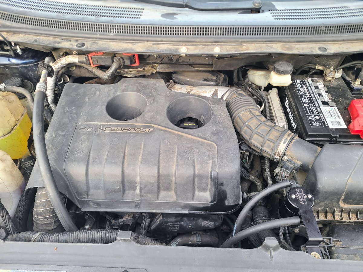

Ok, so I did the turbo swap, intake cleaning, and new valve cover gaskets while I was in there... My problem was the waste gate. Even when the actuator was closed the waste gate could flap open because of the slop in the arm connecting the waste gate. I tried to drop the turbo without taking the axle out, but it was made so much easier to drop the axle as it gave so much room. I also needed to buy a new Dorman V-Band clamp Part# 903301, as the Ford one was too narrow for the Mahle turbo. I am guessing they beefed up the turbo flange thickness after mine was built (9/2011). I recommend having a M14x1.5 tap and die set around as I had to chase and clean out the threads of the block and banjo bolt for the coolant feed line. I will also add I bought and installed the J&L Oil Separator catch can. You can't follow their install instructions as its for a 2015+ but the bracket was easily used to mount on a bolt holding the air intake duct to the rad support.
