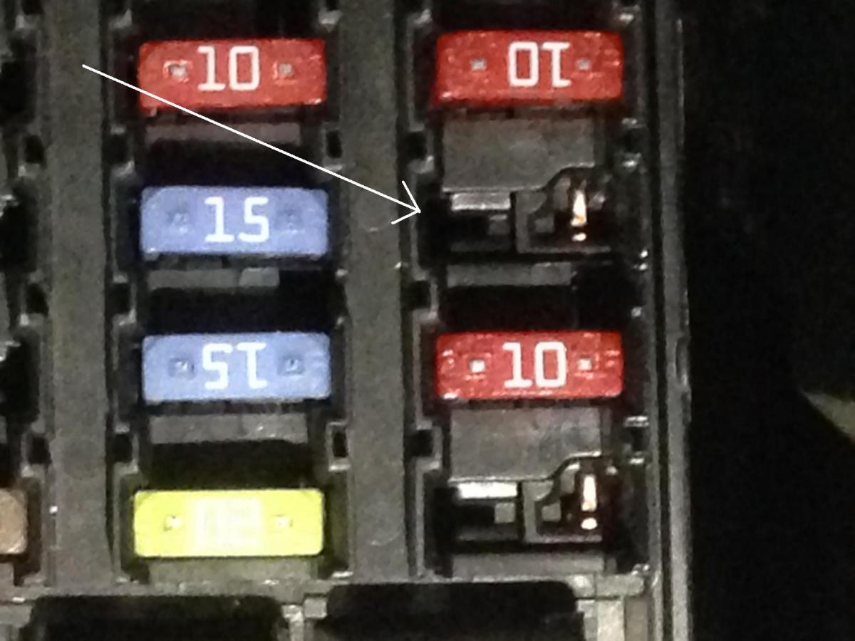

I am looking for the other half of the connector that a fuse plugs into in the battery junction box fuse panel. It would be the side of the fuse that goes to the device. There are unused connectors that energize with ignition and I currently just have a fuse tap plugged into one of them for my DRL power. i would like to install the other side of the fuse holder and connect the power wire from inside the fuse box. I want an actual fuse plugged in for that circuit. Does anyone know if you can buy these? It's the location at the end of the arrow in the picture.
