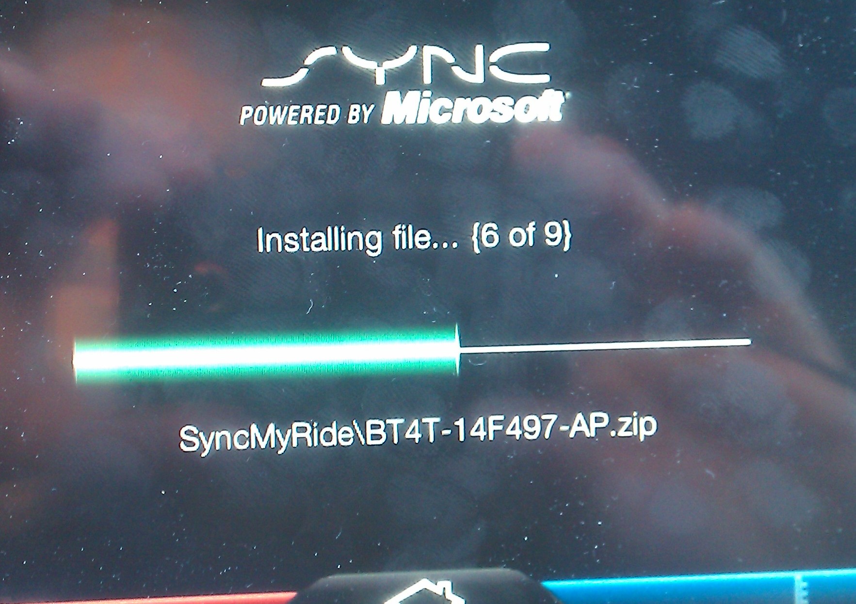

Good news. Was finally able to get the 2.11 update to complete. Called tech team one last time & spoke with an analyst by the name of Brian. Very sharp tech and helpful. He had me pull Fuse 29 for 5 minutes. Then restart vehicle and perform a Master Reset, followed by starting the update. It took about 70 minutes, but it was successful this time. I then reported the install and the site now shows my Edge at v2.11. Will see how performance is on the way home today, but for now it's back to work. Enough play-time this morning. -

i did perform a separate download for each USB drive that I tried. I too thought the same thing, but I downloaded the file using two different PC's among the four USB sticks... You are correct though, I do know how to back out and am not losing anything but time. -

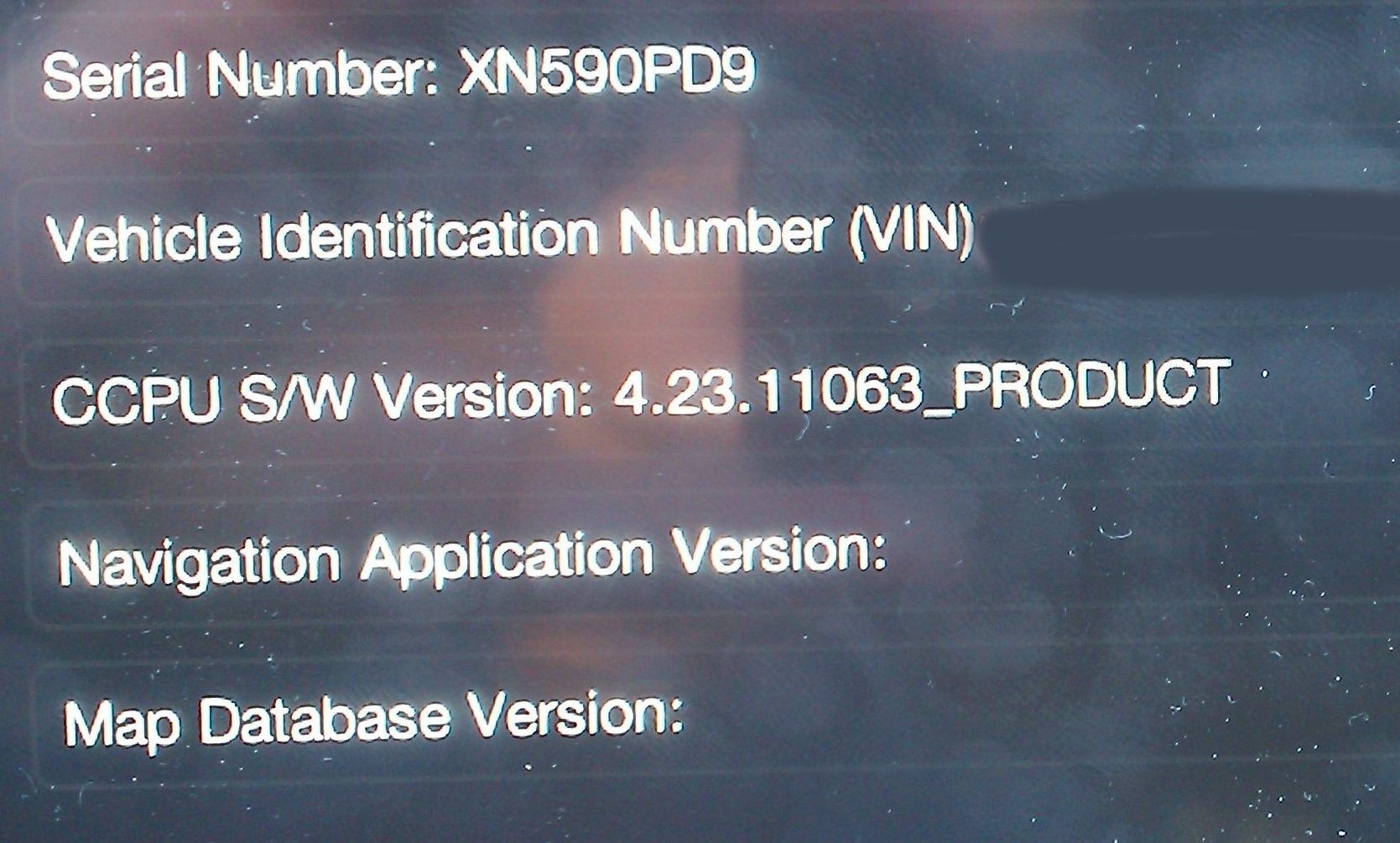

Well, wish I could report more positive news, but after multiple attempts using not one, not two, not three, but four USB drives, I am still getting the same results. The process hangs at the same place every single time. I went and bought a brand new USB drive that had an LED so I could watch drive activity. When the update got to 6 out of 9 files. there was activity for a few minutes then nothing. I guess I am not going to get this update done, and I am not really of the mind to let the dealer have it just to perform this update. I really thought this would be a very straight forward process, but I must have a problem child. Fortunately, version 2.8 has not given me many issues so I will just stay happy with this for now. I am putting a couple screen shots below in case anyone has an idea. Please feel free to post, I am more than willing to try something. Regards! -

After waiting an 50 minutes and still no progress I called the Tech Team. The analyst I spoke with said they had a few reports of this happening. He had me back out of the update, and then perform a Master Reset. After chatting with the analyst, I am wondering if maybe a hidden file on my usb stick could be causing the issue. I am trying to go from 2.8 to 2.11. I did try the update a second time with the exact results: stopping at file 6 of 9. Anyway, I have several other thumb drives so I will grab some coffee and give it another shot this morning. Cheers! -

Well, I am running the 2.11 update right now. To me it seems hung at 6 of 9 files, but I am giving it at least the 45 mins before I toss in the towel and try later. No error messages, just waiting for it to get past the BT4T-14F497-AP.ZIP file. Will update later. -
