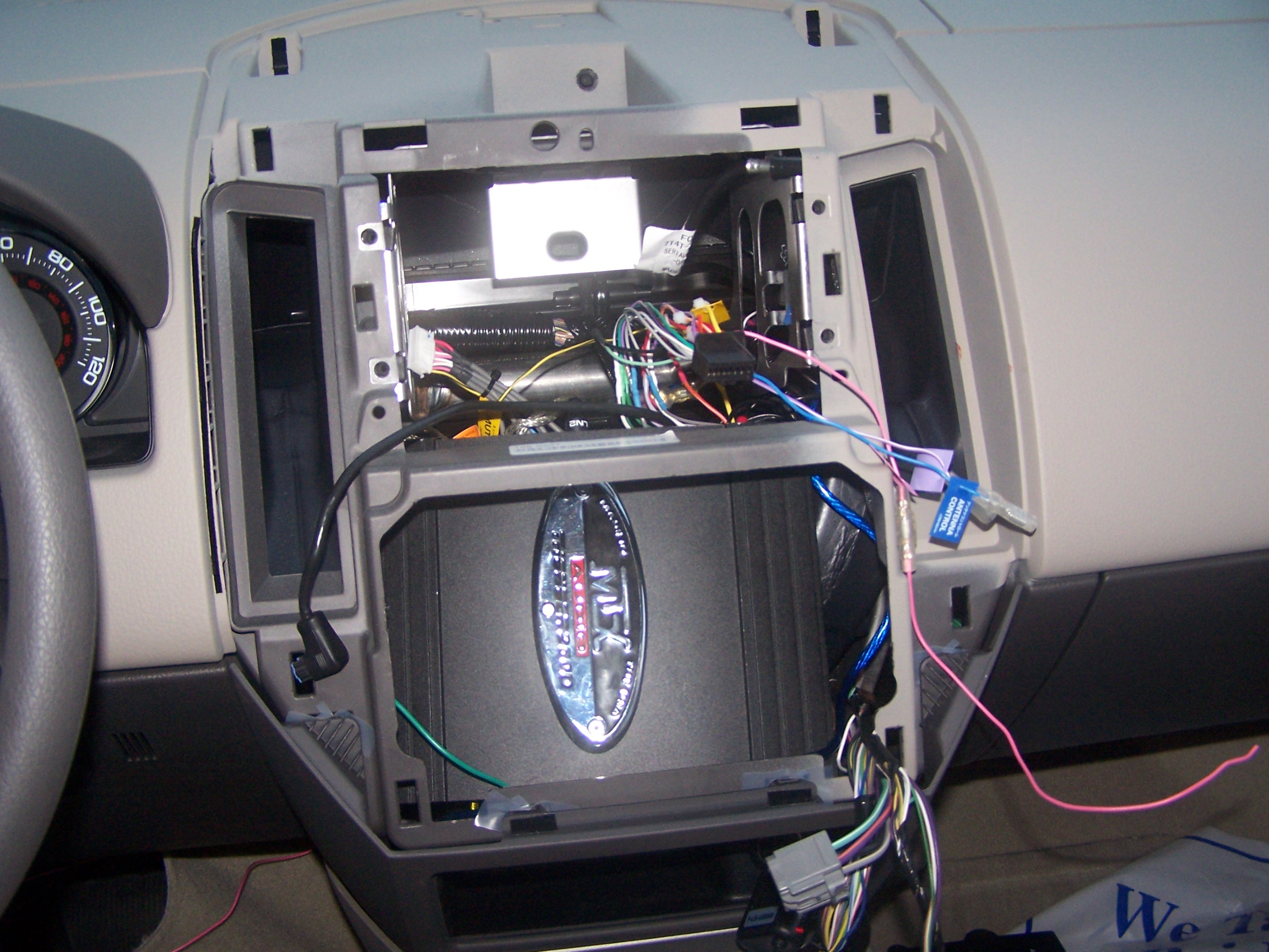

  2. I know. There's not much room for heat to escape. Fortunately the pioneer and the amp have thermal circuits which will shut off the units if they get too hot. There really isn't room in the edge to install the amp under the seats, even this small amp.

  4. Well I have a small sub amp, and was able to mount it under the radio, behind the AC controls. I was also able to install an XM and bluetooth module back there as well.
