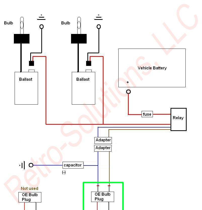

Ahh, okay i forgot it has those on each side, one side you will not use. the side you are plugging those prongs in to the factory harness can use those. I do not think you have to use those...but ill try to explain and could do a diagram quick if you need it... Okay so i had 1 extra adapter piece with my kit, it was black, you attach that plug to the two prongs from the capacitor to the extra adapter piece. Than it will than end with two prongs in the picture above...which would just go in to the OM harness...does that make sense? So can just ignore those and go straight to OM harness, or add the extra black adapter to the capacitor prongs, plug it in to the black/yellow plug (top arrow in picture), and that than makes current to the 2 prongs in picture above, and than those plug in to OM harness.... confused yet? -

Vandeleigh, Those two prongs connect to the factory wiring harness for a stock bulb. It can be either the Left or Right side head light. I was confused too, the diagrams given list it as an adapter (diagrams two posts above yours), when really it didnt have an adapter, and the extra connector I had didnt fit in the factory harness to plug in. So pick which side headlight, put the positive and negative wire in to the light bulb harness, and for good measure just use some electrical tape and wrap them so they dont come unplug. When i figured it out finally in my 07 MKX though, the OM harness didnt say which side was "+" or "-", seeing when you put a light bulb in it, it can only plug in one direction. However it did have a small "A" and small "B" on each side, i used a volt meter, and side "A" was positive, and side "B" was negative in my car. If im correct, those wires just tell the relay that the lights were turned on, than send the current from the battery to the HIDs so that they turn on when your automatic lights to, or you manually turn the switch in the driver seat...does that make sense? I hope im not confusing you more... once i plugged those two prongs in to the driver side head lamps and tapped them, i moved the wire out of the way and than inserted my HID in to the socket and turned it till it was securely locked in the fixture and now drive around in daylight 24/7 :D your labeling is right for the capacitor/ground also. Oh and heres a quick remake of the diagram two posts above yours, note the green box, I tried to show the prongs instead of the labeled "adapter" that isn't there, plugging in the the factory light bulb harness. or if im no help RS will help you for sure, what HID kit did you get? -

You only need one side plugged in, because the power going to the HIDs is coming from the battery line. The only reason you have that one line running in to the OEM harness is so that when you turn on your headlights, the car sends a current through the OEM harness, which will than run to the relay, and trigger the HIDs on. The "to power" wires don't have a harness, they are both a negative and positive and have specific tips on them. they are not just stripped wires, they each slide in to the OEM harness and than i just electrical tapped them in to it. I'll take a picture later and show you what the ends look like if you are still confused. The only thing with the OEM harness is figuring out which side is + or - because its a grey harness and both wires leading in to is are black. I used a volt meter to figure it out, and there should be a "A" and a "B" marked on both sides, "A" was positive and "B" was negative.
