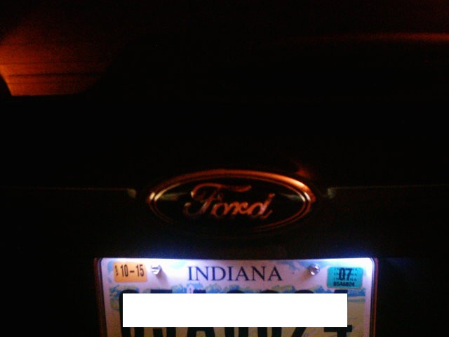

in_edge Posted July 9, 2007 Report Share Posted July 9, 2007 (edited) Replaced license plate bulbs with LED bulbs............ Looks pretty cool-----Bluish~neon cast ...will try to post pics soon!! www.superbrightleds.com WLED-x6 LED Wedge Base Bulbs 6-LED bulbs are non-polarized so they will also work in polarity reversing marker light applications. These are very bright for their size, about the same size as a stock 194/168 bulb. Available in all of our standard LED colors Edited July 9, 2007 by in_edge Quote Link to comment Share on other sites More sharing options...
glenn1104 Posted July 9, 2007 Report Share Posted July 9, 2007 Replaced license plate bulbs with LED bulbs............Looks pretty cool-----Bluish~neon cast ...will try to post pics soon!! www.superbrightleds.com WLED-x6 LED Wedge Base Bulbs 6-LED bulbs are non-polarized so they will also work in polarity reversing marker light applications. These are very bright for their size, about the same size as a stock 194/168 bulb. Available in all of our standard LED colors Do you have a more direct link or a better description of the bulbs you used? Quote Link to comment Share on other sites More sharing options...
in_edge Posted July 10, 2007 Author Report Share Posted July 10, 2007 I used the same bulbs that I had ordered for our 2007 Camry (Traded for the EDGE)....... Go to....www.superbrightleds.com click on "led bulbs & products" click on "12 volt car bulbs" click on "miniature wedge bulbs" I'm using the WLED-X6 bulb cross-referenced with the Camry bulb (2825) The EDGE bulb does not cross-reference (6418) but the are working fine with no issues.... You could probably E-mail them for further assistance... Hope this helps........Posting pics ASAP Quote Link to comment Share on other sites More sharing options...
in_edge Posted July 10, 2007 Author Report Share Posted July 10, 2007 (edited) looks better in person.......more of the "neon-blue cast", like the 'imports' will post later with better digital cam. Edited July 10, 2007 by in_edge Quote Link to comment Share on other sites More sharing options...

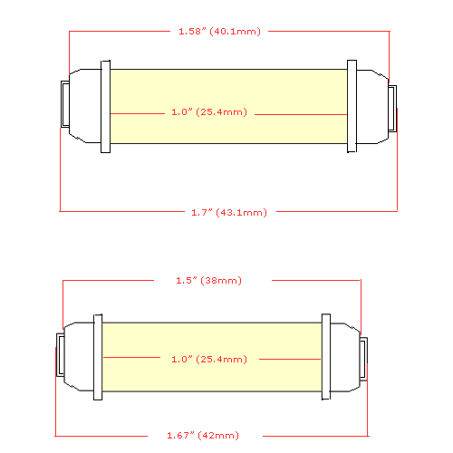

Lex Talionis Posted March 26, 2008 Report Share Posted March 26, 2008 (edited) Here is what I bought from Superbrightleds.com Brake Lights: 3157x25 Red X2 Reverse Lights: 921x12 Cool White X2 Map Lights: WLEDx6 Cool White X2 Plate Lights: WLEDx6 Cool White X2 F Turn Signal: 3157x25 Amber X2 Rear Marker: WLEDx6 Red X2 Here is where the problem starts. Sylvania and Ford say 2825 (W5W) is in the front map lamps and rear courtesy lamp but I can tell you on my Edge the front map lamps are 2825 but every thing in the back is a festoon bulb including the courtesy lamp. Now according to the superbright site all 3 digit lights should be able to be replaced with a WLED series light well if the 578 series is a festoon bulb then it obviously can't be replaced with a WLED series. The only other problem I had was the 921's don't fit into the socket very tight so I had to do a little cutting on the LED case to get it in but I resealed the internals with some silicone to keep them water tight. sure enough.. I find some discrepancies here also with the Ford manual/Sylvania site versus going and looking for myself: It claims the License plate is 6418.. which is a festoon style bulb (100% round and long ovalized) which is NOT what is back there. what IS back there is more similar to a 168/194 bulb style (round front bulb end with flat tail) it claims that the Rear Courtesy Lamp in the cargo area is a 2825 bulb (round front bulb end with flat tail) which is NOT what is back there. what IS back there is a festoon style bulb (100% round and long ovalized) that being said... 578 for 3 rear dome lamp seems correct as it is a festoon style bulb (100% round and long ovalized), but shorter than the Rear Courtesy Lamp in cargo so not technically the same bulb model. 2825 front map lamps seem to be correct also as that is a round front bulb end with flat tail style, which is what is there, but not same dimensions as license plate style technically though it seems. BTW - how the hell did you get to the 2 front map lights? when trying to pry down the clear plastic trim around that section you can get it 80% reveled to see the bulb, but the section facing the windshield is tough and I am afraid to man handle it in fear of breaking it to actually get access enough for my fingers. Something else to consider here on the LED 'festoon' bulb placements - those on the ceiling rear dome lamp and the rear Courtesy cargo bulb - is the angle they disperse light. For example, a regular bulb emits light 360 degrees and light shining back reflects off the reflector to bounce forward and fill an area with more light. Well, the festoon style LED bulbs have bulbs mounted on 1 side and are placed facing out. so, there is no light facing back (or up or down) to bounce off a reflector and fill the space. Now.. why this might matter is that if you put these above you... will they shine straight down in a beam like a flashlight rather than fill the general area? and in the cargo area, will they send a beam across to the other side of the trunk rather than generally fill the cargo area? Edited March 26, 2008 by Lex Talionis Quote Link to comment Share on other sites More sharing options...
Lex Talionis Posted March 26, 2008 Report Share Posted March 26, 2008 as it seems festoon bulbs are based on actual size, rather than cross reference of of numbers (i.e., Ford versus Sylvania versus what is stamped on them) here is a diagram I made in an effort for me/us track down the exact correct size LED bulb for the 3 rear dome/map ceiling light and the 1 rear cargo area. These are based on exactly what is in my 2008, measured with calipers. (it seems the front map lights and license plates are easier to find and are not festoon anyway). I see some measurements on the superbrightleds.com website, but not exact matches to these sizes. and a call to them was a bit fruitless. maybe these are just oddball sizes and hard to find... Quote Link to comment Share on other sites More sharing options...
