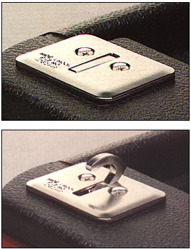

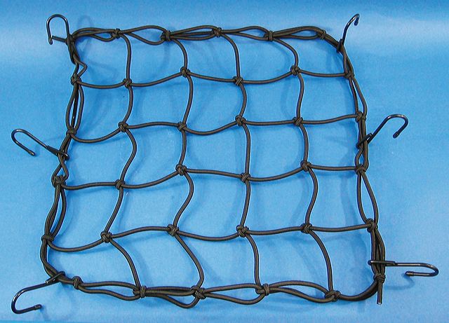

Lex Talionis Posted November 10, 2008 Report Share Posted November 10, 2008 one bummer in this car is that it has no tie down loops. I, several time, considered mounting a few of these - or one like it - in the back so we had loops to tie to, but did not do it (yet) get 4 of these and then a cargo net from a motorcycle shop (as they are smaller) and there you go Quote Link to comment Share on other sites More sharing options...

Lex Talionis Posted November 10, 2008 Report Share Posted November 10, 2008 Have a link for those? It may require reinforcing the trunk floor slightly so it doesn't curl... Or perhaps putting them on the sides and having the net hold the goods against the side... but then I would have to take the panel off and put some reinforcement behind the mount.. some sheet metal should do nicely for that. reinforcement would be very easy to do if you felt it needed (depending on load type you plan to 'secure' or just 'hold')... I would likely mount 4 to just the sides (as I have a nice cargo liner on the floor) and low as possible. these flush mount pop up kinds are great as they can be made flush so you can still pull up the floor, and they are out of the way when not in use. I had ones in my VW that folded out of the way when not in use. These ones I showed are rather costly as they are nicer, but I have seen similar for a lot less, I just showed ones I could Google quick (cargo tie downs) to make the point. click here for the 2 I showed here is a much cheaper option WITH backing plates: click here Quote Link to comment Share on other sites More sharing options...

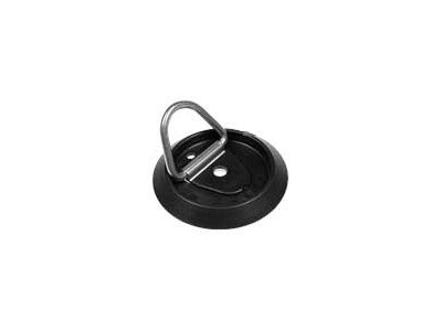

Lex Talionis Posted November 13, 2008 Report Share Posted November 13, 2008 (edited) Here are some that are kind of nice (and cheap) and likely what I would do seeming we do not need 5000lb ratings and 4 bolts.. 4$ per tie down. matching black base to my interior color, plastic body & metal d-ring should be limited to no rattle. with a single hole to mount, only 1 hole to drill and easier backing if you really felt it needed (I do not.. just use a fender washer and nut/bolt combo). not as flush as a "recessed" version, but still pretty low profile. you could even drill 2 into the backs of the rear seats so you could have 6 points (1 on each seat, 2 on each wall) and these should still allow you to lift up the floor cargo access. Edited November 13, 2008 by Lex Talionis Quote Link to comment Share on other sites More sharing options...

Splitpi Posted November 14, 2008 Author Report Share Posted November 14, 2008 I like that last one with the black plastic. 1200 lbs is far more than I'll need. I was thinking of putting 4 on each side of the car and 4 on the trunk floor. That should give me a good range to hook things on. Now I just need to do it when the wife is not looking Quote Link to comment Share on other sites More sharing options...
