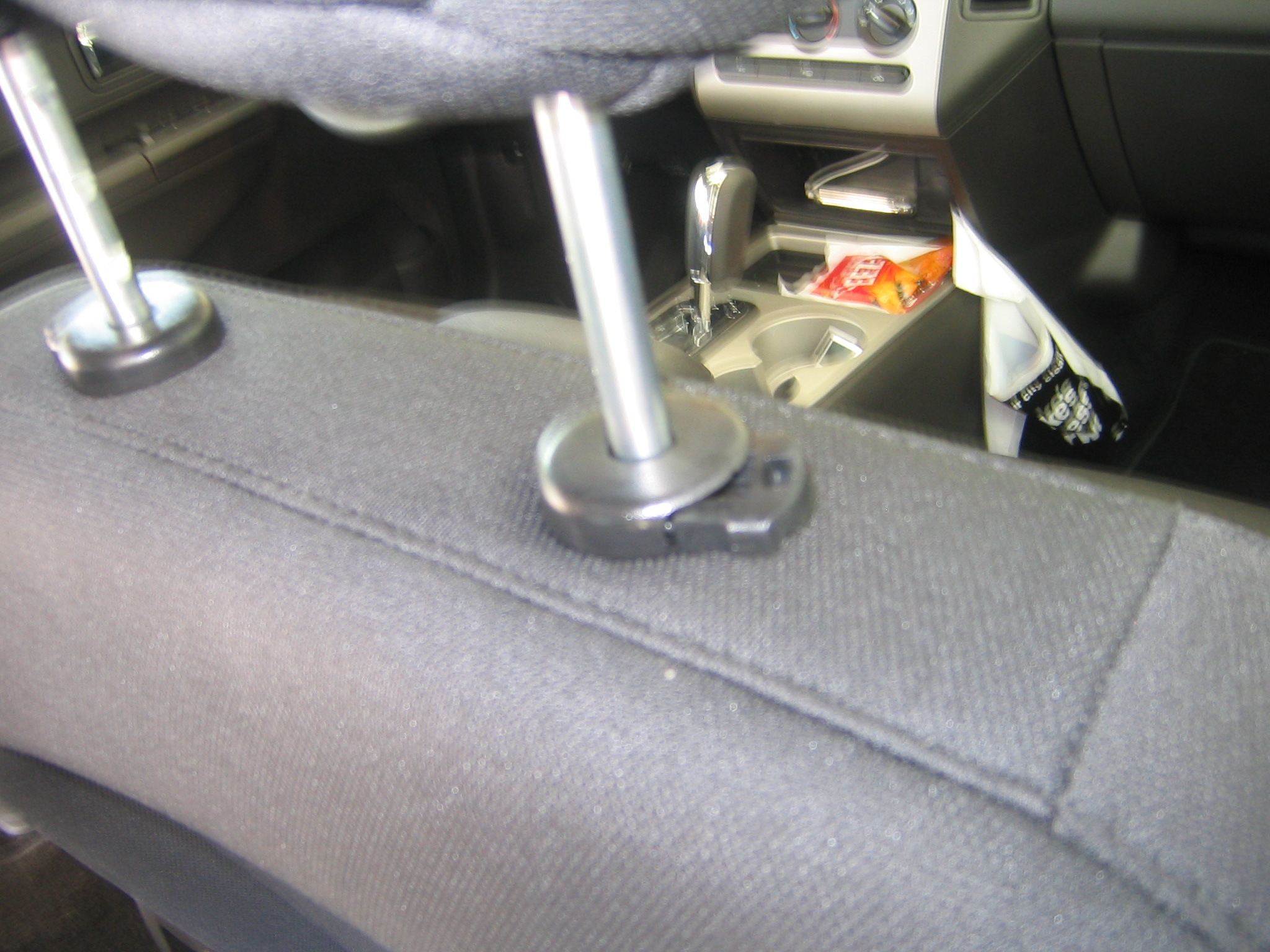

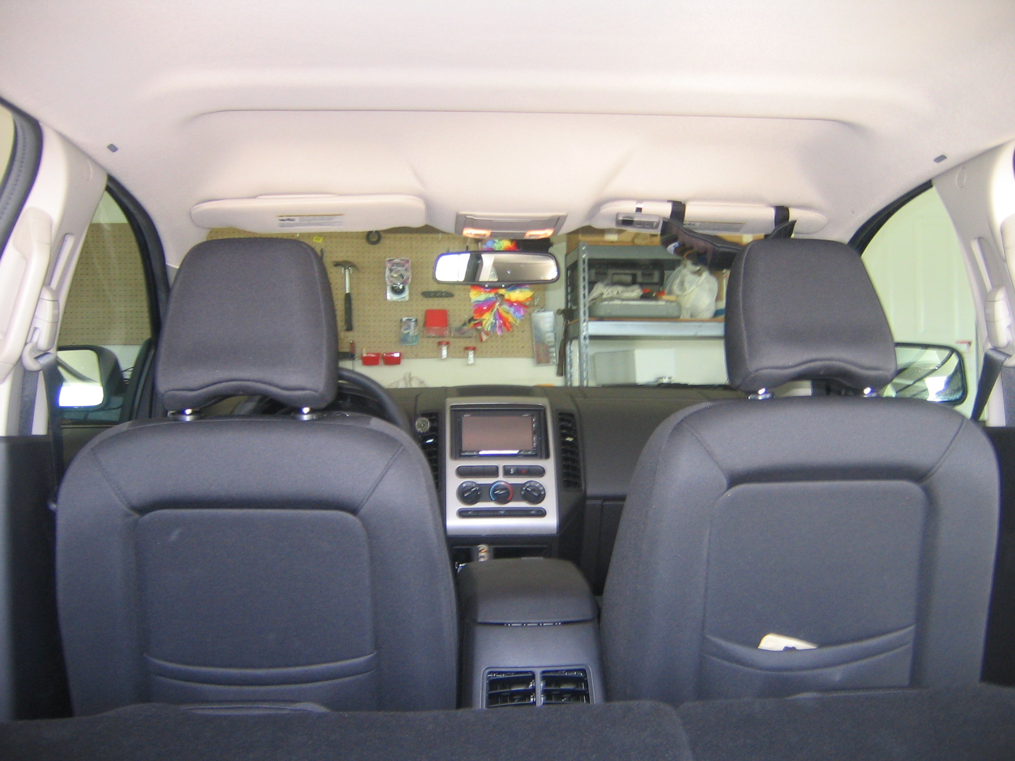

JC4ME Posted July 17, 2008 Report Share Posted July 17, 2008 (edited) Well they came in today. I purchased a pair of 7" Accelvision Dual DVD Universal Headrests for my wife's 2008 Edge. I purchased them from qualitymobilevideo.com They were 513.00 with shipping. I liked them because they each play their own seperate DVD. Two kids + Two DVD players= no arguments (atleast about what to watch). Easy install, but I am disappointed in the AV in/out features. You can show the same DVD on both monitors if you want, but the Playstation 2 (sent in through AV IN cannot be sent out through AV OUT to the other monitor. Therefore Two people must watch one monitor to play a game. Picture quality is good. Wireless Headphones are nice for the kids. Took a few pics for those of you thinking of doing the same thing. Edited July 17, 2008 by JC4ME Quote Link to comment Share on other sites More sharing options...
Lex Talionis Posted July 17, 2008 Report Share Posted July 17, 2008 nice.. thanks for the photos. is it a little odd to have leather HR with fabric seats? BTW, how about part #s for the HR you have here as I do not see a +-$500 option under the Ford Edge vehicle finder. So, you used a more generic version, but which one? BTW, are the threads and stitching actually white as it is in an Edge with leather? in some photos it looks like it (#7), in others not so much (#1). Quote Link to comment Share on other sites More sharing options...
JC4ME Posted July 18, 2008 Author Report Share Posted July 18, 2008 nice.. thanks for the photos. is it a little odd to have leather HR with fabric seats? BTW, how about part #s for the HR you have here as I do not see a +-$500 option under the Ford Edge vehicle finder. So, you used a more generic version, but which one? BTW, are the threads and stitching actually white as it is in an Edge with leather? in some photos it looks like it (#7), in others not so much (#1). The stitching is all black, the flash makes it look lighter. Believe me those are not leather, they are vinyl and they match well close up. The cloth seats almost look like polyester so the slicker surfaces blend well. Here is a direct link Quality Mobile Video The AV thing has worked out. I just had to run a few RCAs to the head unit and use its two zone feature. Now all three monitors, dash included, can play playstation or watch a video. We will see how they do on the trip. That will be the real test. Quote Link to comment Share on other sites More sharing options...

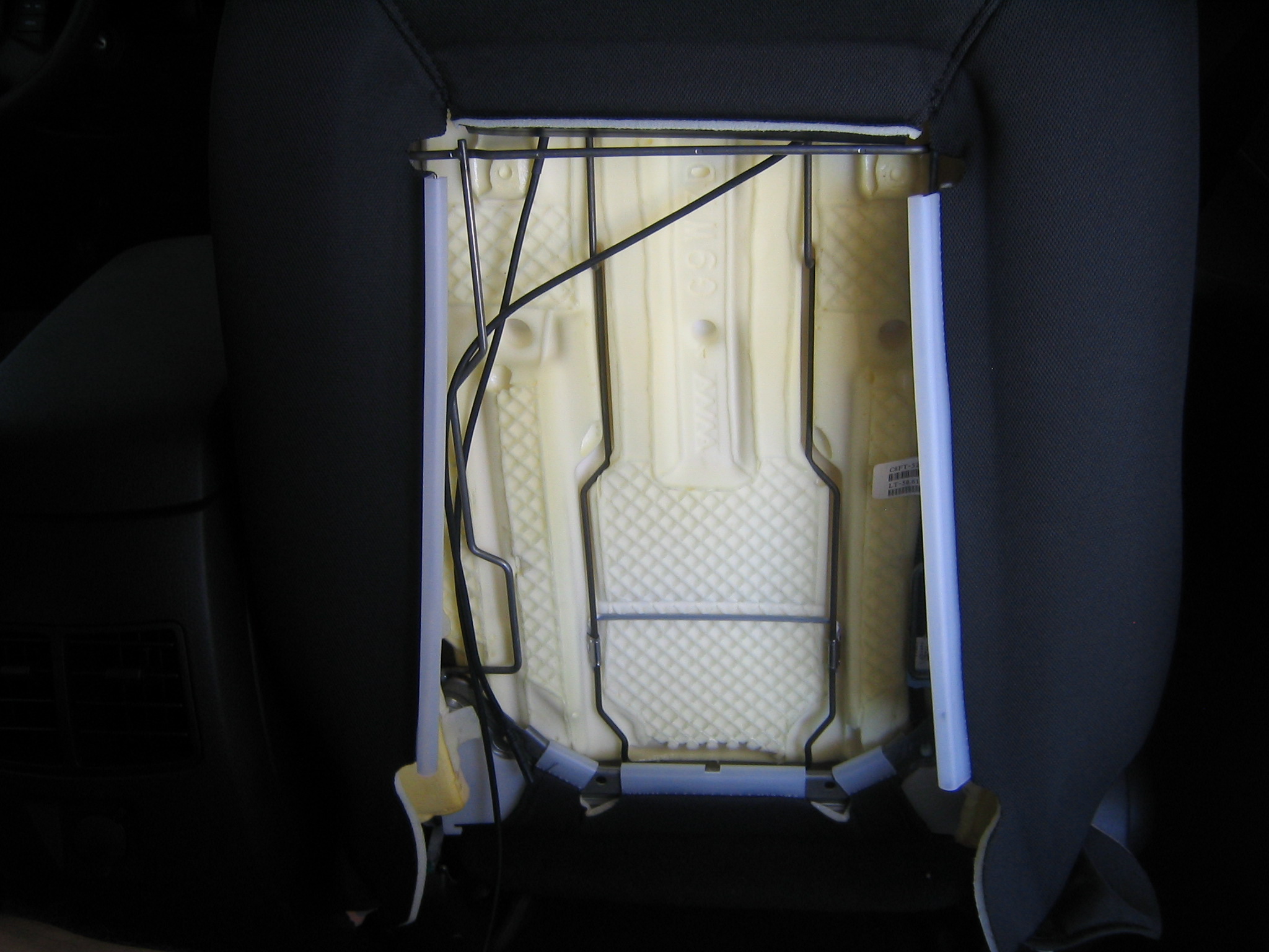

thedugan Posted August 21, 2008 Report Share Posted August 21, 2008 Got my kit in the mail today Any tricks for removing the back of the seats for access to the wires Can you just power it off the cig lighter in the center console? Quote Link to comment Share on other sites More sharing options...
thedugan Posted August 21, 2008 Report Share Posted August 21, 2008 any tricks to removing the back of the seats? What did you use to remove the seat backs? Got my kit in the mail today for my 8 day old Edge Can you just power the DVD's by the cig lighter in the center console? Quote Link to comment Share on other sites More sharing options...
dgore68 Posted August 22, 2008 Report Share Posted August 22, 2008 any tricks to removing the back of the seats? What did you use to remove the seat backs? Got my kit in the mail today for my 8 day old Edge Can you just power the DVD's by the cig lighter in the center console? ***It actually was really easy. There are two plastic clips at the bottom....pop those out of the holes then slide the back down and off. Works better if you lean the seatback forward. Our DVD kits were for hardwiring, so we went to Radio Shack and bought a double 12v converter and we plug it into the 12v outlet in the center console to keep the kids from kicking it. Good luck! If you have any problems, this post page rocks! Congrats on your Edge....I love mine!! D- Quote Link to comment Share on other sites More sharing options...
thedugan Posted August 22, 2008 Report Share Posted August 22, 2008 Do you use a special tool to pop them off the clips. Any kind of a certain trim tool? how did you snake the wires into the console and did you drill any holes.. thanks Doug Quote Link to comment Share on other sites More sharing options...
thedugan Posted August 23, 2008 Report Share Posted August 23, 2008 (edited) All installed :D Headrests are in and wired to cig lighter for now. Have a splitter on the cig lighter to run both units Need to go buy AV cables to hook the units together so I can play one DVD to both units Then Im all set. Will hardwire the units later, Want to see if there is a ignition keyed wire under the seats to power the units. That way when the car is not running the units turn off. Doug Edited August 23, 2008 by thedugan Quote Link to comment Share on other sites More sharing options...
thedugan Posted August 23, 2008 Report Share Posted August 23, 2008 Where did you run the wires coming out of the back of the seat and then going to the console. Got a pictures of how you snaked it Quote Link to comment Share on other sites More sharing options...
