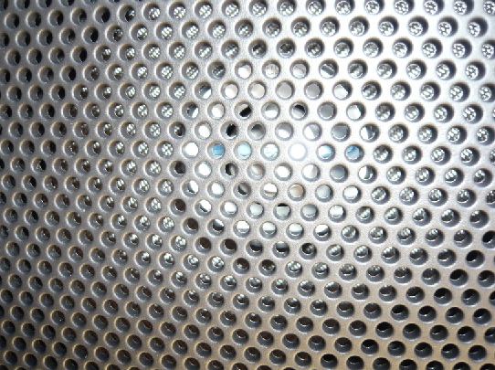

as I just posted to your thread, and want to do here so it is known and clear...
for the record... this is absolutely, 100% not true.
I have Infinity Kappa 682.7cf in both front and rear - as you know - and they are not even close to touching the grill/door panel. not even close. CF is wrong. there is a solid 1/2 inch from Tweeter to the door panel grill.
Here is a photo. I know, it is very hard to capture this thru the grill.. but the best I can offer. No matter what, from an angle, you can clearly see nearly .5 inches of space.
Edited by Lex Talionis
Hey ... that's what they told me over the phone as I had asked about these for the rears ....
no worries.. really only an issue if you badly wanted them in the rears I suppose.. you did read my install though and saw that I pulled it off perfect without any issues and made no mention of them touching the grill, but still believed CF :shades:
anyway, I am sure what you got will rock and it WILL be better than stock for damn sure. as we know, there is no way they can test all speakers in all cars (front and rear to boot)... they likely just use speaker and door panel dimensions from the manufacturer to guesstimate probable fitment - but were wrong in this case.
good luck... post back when you get them installed as then we will have another rear option for people to read about.
