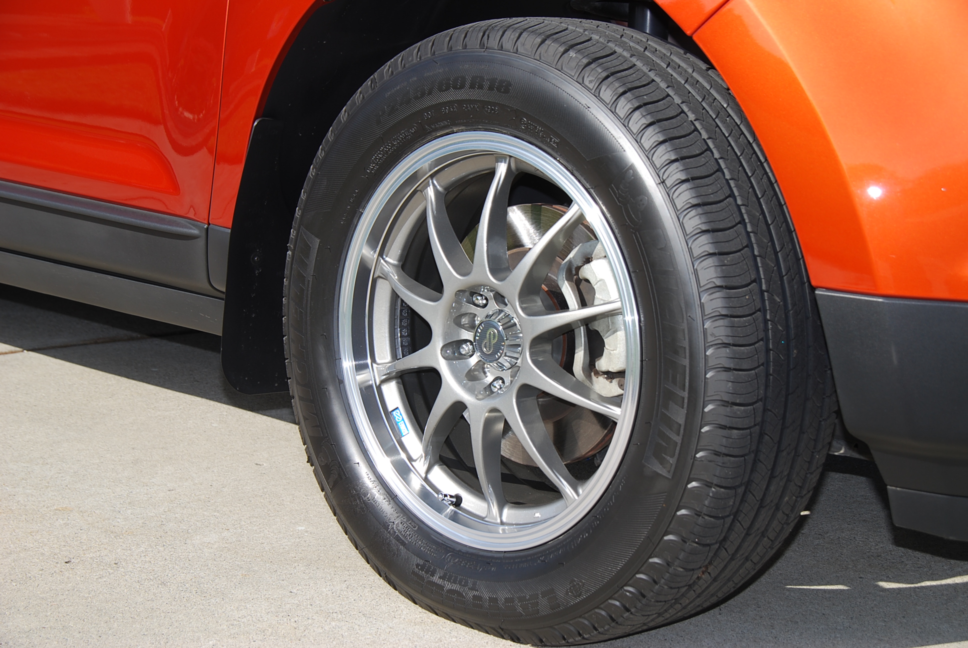

dadrett Posted April 24, 2009 Author Report Share Posted April 24, 2009 (edited) Wheels & tires ordered from America's Tire (elsewhere in US they're Discount Tire.) Wheels are 18", 10 spoke, silver Enkei J10s. Nice moderate wheel with sort of classic :shades: simplicity. A family member & a friend lobbied for black. When I was 44, I did +1 with black Enkeis on '85 Escort. Now I'm 1/2 again older, more conservative & feel I should project more refined image. :hysterical2: Tires are 245/60-18 Michelen Latitude Tour HPs. Seem to have good specs @ reasonable price AND :happy feet: a $70 rebate. Got another $100 off for financing @ 0% for 12 months. Edited April 24, 2009 by dadrett Quote Link to comment Share on other sites More sharing options...

dadrett Posted May 14, 2009 Author Report Share Posted May 14, 2009 (edited) Wheels & tires installed 5-12-09. Started process 4-21. One wheel came in, but was damaged. Ordered replacement. Meanwhile 3 wheels arrived, but no replacement. Left town for a week. Phone message 5-11: wheel coming from Texas would be here 5-12. Three weeks to the day. In the meantime, kid who wanted my old wheels/tires on Craigslist changed his mind. America’s Tire gave me $200 credit for them. So all told, my cost $1299.24. BTW, bands for sensors were $40/set. PS: Michelin Latitude Tour HP is $100 more at COSTCO. 5-18-09 -- I've discovered an unexpected consequence - speedometer is now spot on w/TomTom real time MPH.. Edited May 19, 2009 by dadrett Quote Link to comment Share on other sites More sharing options...
