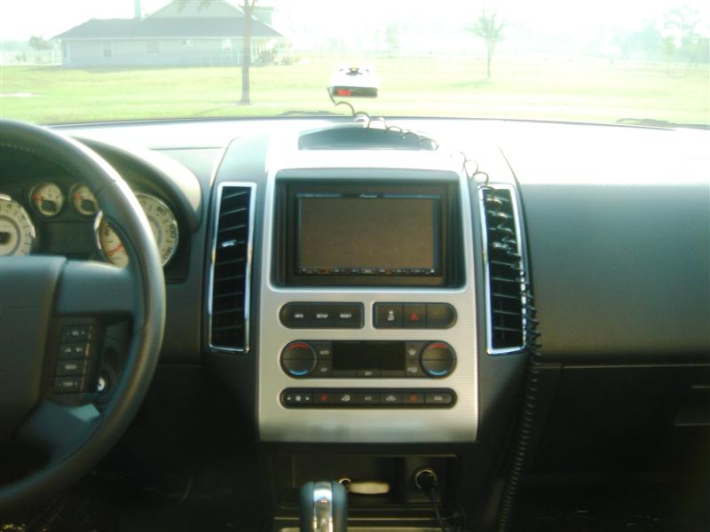

Abrannan19 Posted October 9, 2007 Report Share Posted October 9, 2007 (edited) Crutchfield says all 4 door speakers are 6x8For a couple reason, including keeping the factory look. Not having to do an adapter leaving another opening/cubby below the stereo, the fact that I can install a new head unit later, $, etc. The factory stereo doesn't look all that bad and the Sirius and in-dash 6-disk CD changer wouldn't have to be tampered with. I don't want or need a DVD player in the dash. I'll never use it. I figure get the sound up to par while keeping the stock look... for now. ok I gotcha..but you 'could' do a double din with dvd and just not use it.. for only a little more $$ then a single din, and not have any cheesy cubby I am not trying to push anything just saying..but with the Pioneer AVIC-Z1orZ2 you wont need a 6 disc cd changer..once you insert the cd one time after about 10 mins all of the music is ripped off the cd and stored to a harddrive. Its freaking awesome. Not to jack a thread or try to get compliments..just to show a pic..this looks pretty close to stock to me..IMO better..once again jmo.. you be the judge. Edited October 9, 2007 by Abrannan19 Quote Link to comment Share on other sites More sharing options...

scoopo Posted October 10, 2007 Author Report Share Posted October 10, 2007 (edited) Abrannan19: That DVD head unit is nice. I really like the CD ripping feature. I had figured on installing an after market head unit after I got the speakers, amp, and sub all sorted out and installed. (then recovered financially again) I'll definitely be looking closer at one of those now though. Maybe go ahead and get it all done at once after all. Thanks jeffreybehr: Dude! That's one helluva system you have in your home. Nice! Are the tweeters in your Edge the little thing on the dash up near the windshield? That's interesting. Was it a pain to run the wires? I don't think I'm all that interested in busting out the hacksaw and duct tape so I believe I'll have to pass on the great deal you're offering for the B/MR drivers. I got in a short chat session with a Crutchfield Product Advisor briefly yesterday. He said the Infinity Kappa 682.7cf speakers will fit in the front door but not in the back. He then said the Infinity Reference 6822cf reference speakers would fit. I guess I need clarification on that (didn't have a lot of time when we were chatting) because I'm seeing the first set specs showing 2 1/4" Top Mount Depth and 2 3/4" Bottom Mount Depth while the reference set shows 2 7/16" Top Mount Depth and N/A Bottom Mount Depth. That's 1/16" more on the reference set than on the first set for Top Mount Depth. Now I will freely admit I am no expert on this stuff but that doesn't appear to calculate. Another speaker question while I'm at it. What would you all recommend for a sub-woofer enclosure? I'd like to install the sub in the side where the factory audiophile sub goes. Someone (can't remember who offhand) installed an after market sub there and it looked really good. As I don't have the factory sub is this even an option? If so, anyone have some dimensions for a custom box that would fit? All the boxes I've found so far are stand-alone enclosures and most have black "carpet" on them. I don't think that would look very good with my camel interior. Thanks for all the input and assistance Edited October 10, 2007 by scoopo Quote Link to comment Share on other sites More sharing options...

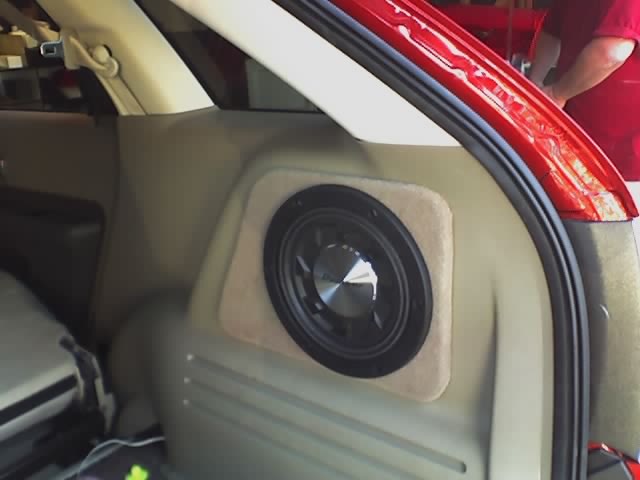

alwaysbikn Posted October 11, 2007 Report Share Posted October 11, 2007 (edited) I have Infinity Kapa's front and rear...with a 10" Pioneer shallow mount sub in a custom box and a Kicker 5 chanl. amp driving the whole system with the stock deck....it ROCKS!!! Edited October 11, 2007 by alwaysbikn Quote Link to comment Share on other sites More sharing options...

alwaysbikn Posted October 12, 2007 Report Share Posted October 12, 2007 The Kapa's fit the front and rear perfectly. The holes in them line up with the holes in the door from the factory speakers and there is just enough room by the window motor to mount the cross over. I don't have any dimensions for the sub box....I had a professioal mobile install guy come to my house and build/install the box, sub and amp. He used the extra wood panel on mine to get the box bolted nice and tight to the plastic panel so there is no rattles....I'm sure there are several ways to mount it though. Quote Link to comment Share on other sites More sharing options...
