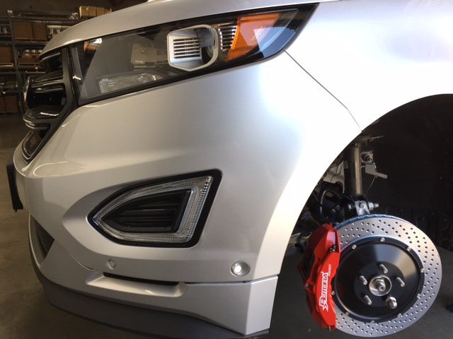

Xtra Posted January 10, 2020 (edited) Report Share Rotora 6 piston 380mm front Edited January 13, 2020 by Xtra 1 Quote Link to comment
handfiler Posted January 11, 2020 Report Share Sweet! 480mm = 18.9''. Is that a typo? Quote Link to comment
Xtra Posted January 13, 2020 (edited) Report Share yes it is a typo my bad they are 380mmI will fix that. Thanks for catching that Edited January 13, 2020 by Xtra 1 Quote Link to comment
Nelson Combe Posted January 20, 2020 Report Share Wow. I've been hunting for a disc/caliper upgrade for my Ford Edge Vignale 2016 for quite some time and these look amazing. Can you supply me with all the spec, manufacturer details you've used on your Edge? I'm in Scotland so might have to source different manufacturers but I'd love this look. Quote Link to comment
ONEDGE16 Posted January 20, 2020 Report Share On 1/20/2020 at 4:28 PM, Nelson Combe said: Wow. I've been hunting for a disc/caliper upgrade for my Ford Edge Vignale 2016 for quite some time and these look amazing. Can you supply me with all the spec, manufacturer details you've used on your Edge? I'm in Scotland so might have to source different manufacturers but I'd love this look. Expand http://www.rotora.com FORD FORD EDGE 2015-2020 (CD539N) Front: 6-Piston | 380x32mm | Street Pads | Stainless Lines Rear: 2-Piston | 350x29mm | Street Pads | Stainless Lines | Electronic Parking Brake System Type: Street Challenge Caliper Finish: Red Disc Type: 3-D Drilled | 2-Piece Disc Quote Link to comment
Xtra Posted January 20, 2020 Report Share Mine are the Rotora Street Challenge brakes listed above. All the specs are the same except I have 4 piston calipers in the rear and I use the Ceramic pads. Loran is the man to ask for at Rotora and please mention Xtra sent you from this site. I receive nothing but you might get a substantial discount on your purchase . They also make non drilled slotted rotors that are stronger than the drilled ones but I like the look of the drilled rotors and I have personally put them to the test. I know for a fact that the stock brakes faded, smoked and smelled up the place on my friends car while my Rotoras were happy and asking for more when charging through my backyard canyons.These are top shelf brakes and the price reflects that. The electric parking brake stays intact as does the ABS. You can get the calipers in different colors as well. Quote Link to comment
