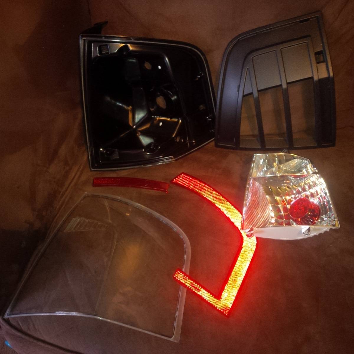

that's my plan...to do a full detailed post on all the mods I've done so far....but the lack of time is killing me....I work 14hr days 6 days a week..so not much time to sit and type....
all it takes is patience really.....in a nut shell what I did was bake the lights in the oven @265 for 5mins then used a butter knife to SLOWWWWWWWLY work around the edges of the clear plastic and pry open....I also used a heat gun to reheat any troublesome spots...
the key is being very patient and gentle...
i'll try to do a proper write up when I can find some free time
