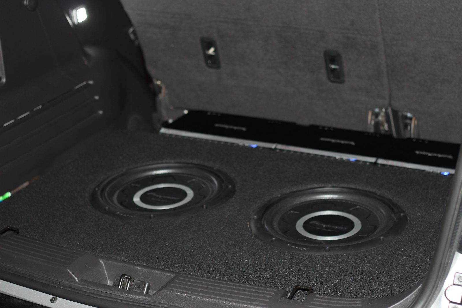

three rockford fosgate amps along the back of the box. One is a 500.4 and runs two sets of RF component speakers up front and in the back seat area, the middle one is the mono 700.1 watt RF amp that runs the two 12's and the one on the far right is a 300.1 mono amp that runs the 10" sub in the factory location. The 10" sub is actually set to play bass between 100-250hz so it runs as a mid base speaker.

There is a boosted rail technology RF amp under one of the bigger Amps that runs the center channel and the D pillar speakers. That amp is running up around 250 watts, so I guess things are getting close to 2000 watts. I just installed a Fosgate 10 farad hybrid type capacitor and it really helped tighten up the bass. The Amps seem like they are not heating up as fast either. It was a good idea to add a quality capacitor for certain.
