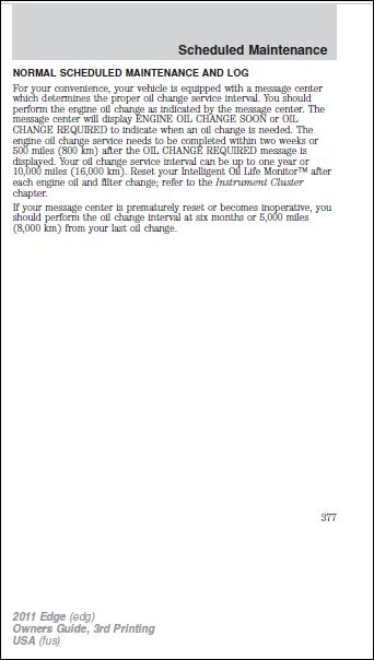

omar302 Posted May 20, 2016 Report Share Posted May 20, 2016 (edited) Hi All, Does anyone know how many miles the 100% oil minder setting is? I usually change oil/filter around 3000 miles. The last time I changed oil I set the minder to 50% . the oil monitor came on at 2000 miles. which is telling me 4000 miles is 100% ??? We drive normal conditions. Thanks Larry From the owners manual:Your oil change service interval can be up to one year or 10,000 miles (16,000 km) With my 2011 MKX, I always reset it to 50% and consistently get the reminder at 5000 miles. For me it is so consistent that I don't believe it takes any thing into consideration except for distance. Also note that were I live we get extremely high weather, easily 120+ for most of the summer. Also our driving is an extreme city cycle. Edited May 20, 2016 by omar302 1 Quote Link to comment Share on other sites More sharing options...

omar302 Posted May 21, 2016 Report Share Posted May 21, 2016 I did not see IOLM in the manual. It is mentioned briefly on page 377. Maybe since 2011 was its first year it was implemented correctly or on earlier builds, though mine is a May 2011 build. Quote Link to comment Share on other sites More sharing options...
